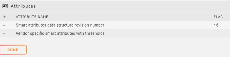

2.) If these drives are connected to a HBA, the HBA behaves different too. Unraid fails to spindown drives. In fact all 24 drives are affected and don't spin down any longer. Standard spindown is broken at this point. "SAS spindown" app needs to be installed to overcome that problem.
3.) Unraid GUI fails to show SMART values. Again all 24 drives are affected. The "Attributes" section on the SMART page is empty. "smartctl -a" still works. Before somebody asks: The drives were spun up while trying to show SMART values in Unraud GUI.

4 hours ago, hawihoney said:
After install of 6.9.0/6.9.1 the Unraid server hosting five of these HUS726020ALA610 drives behaves completely different.
I got same issue that attribute show similar result ( mine revision 4 and you were 16 ) on a disk with USB bridge (SAT mode access), but it will show all attribute if click download "report"
Your case haven't bridge but those disk have Instant Secure Erase (ISE) feature, But I haven't further troubleshoot or report here, it likely a bug.
3.) Unraid GUI fails to show SMART values (all 24 drives are affected
I haven't notice that because I have one disk only.
I have other 7K6 disks ( no ISE ), confirm no problem on 6.9.0 / 6.9.1
