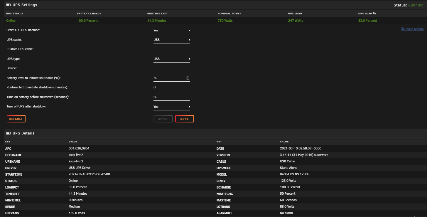

On the unraid dashboard I can see the readout of power draw and it changes and corresponds to the UPS screen, so from that respect I can confirm the USB cable is functioning.
Diagnostics look all OK on the UPS settings page.

do you have the apcupsd running on your server?
I assume that if I can see battery level, load, and all the metrics through unraid that it is running. Perhaps not a good assumption?
