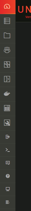

Dear Support Team,
after a restart of unraid (whole server) i lost the menu point for the VM´s?! Docker is still there.
The vdisks are there but there no menu to start the vm´s like usual.
Nothing in the left bar and nothing on the "Dashboard" view.
image.png.6530d1d5b8f38be1470cd72a5e2fede1.pngimage.thumb.png.519b5a399d33260d9b8b0a4266d40985.png
after 2 restarts still nothing there :(

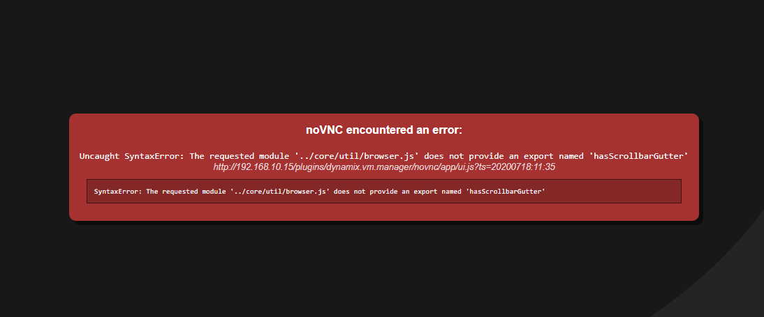

If i want to open "VNC" on the VM´s via Unraid Dashboard it shows me this:

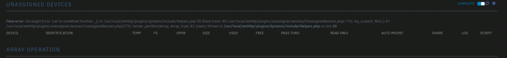

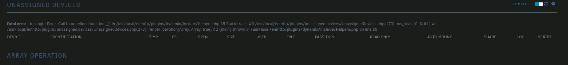

on the "Main"-Dash on the UNASSIGNED Devices Area it shows this:
Clear your browser cache

Thank you @Squid VNC "Error" now gone.
Leaves just the UNASSIGNED Error unsolved for now.
How about you update UD.  The version you have installed is almost a year old.  Before asking for help with a plugin, be sure you have the latest version installed.
Oohps! All updated and all fine now! sorry to bother you and thank you!
