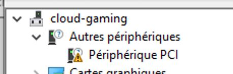

VM with GPU Nvidia RTX2070 Super. Windows don't detect GPU
Hello all,
I don't think I'm the first to have a problem like this. But I have searched on the forum / google / youtube. And I can't find the solution. Or I don't understand English well enough.

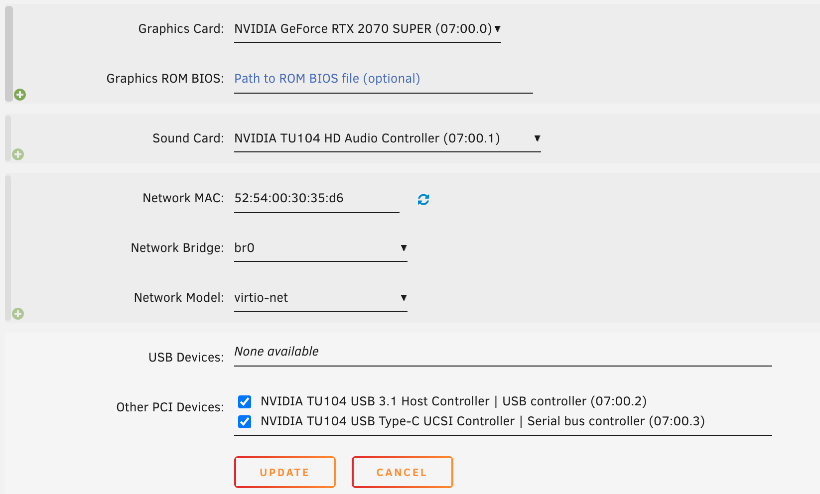

I created a VM with GPU Passtrough, I deleted NVC to use my graphic card. I can acces to remote desktop now.
But WINDOWS does not detect GPU.
Thank you in advance for your help !

XML
<domain type='kvm'>
  <name>VM-Gaming</name>
  <uuid>62027e03-4eed-d96b-6c1a-3911c3201c74</uuid>
  <metadata>
  </metadata>
  <memory unit='KiB'>13107200</memory>
  <currentMemory unit='KiB'>13107200</currentMemory>
  <memoryBacking>
    <nosharepages/>
  </memoryBacking>
  <vcpu placement='static'>8</vcpu>
  <cputune>
    <vcpupin vcpu='0' cpuset='2'/>
    <vcpupin vcpu='1' cpuset='8'/>
    <vcpupin vcpu='2' cpuset='3'/>
    <vcpupin vcpu='3' cpuset='9'/>
    <vcpupin vcpu='4' cpuset='4'/>
    <vcpupin vcpu='5' cpuset='10'/>
    <vcpupin vcpu='6' cpuset='5'/>
    <vcpupin vcpu='7' cpuset='11'/>
  </cputune>
  <os>
    <type arch='x86_64' machine='pc-q35-5.1'>hvm</type>
    <nvram>/etc/libvirt/qemu/nvram/62027e03-4eed-d96b-6c1a-3911c3201c74_VARS-pure-efi.fd</nvram>
  </os>
  <features>
    <acpi/>
    <apic/>
    <hyperv>
      <relaxed state='on'/>
      <vapic state='on'/>
    </hyperv>
  </features>
    <topology sockets='1' dies='1' cores='4' threads='2'/>
    <cache mode='passthrough'/>
    <feature policy='require' name='topoext'/>
  </cpu>
  <clock offset='localtime'>
  </clock>
  <on_crash>restart</on_crash>
  <devices>
      <source file='/mnt/user/domains/VM-Gaming/vdisk1.img'/>
      <boot order='1'/>
      <address type='pci' domain='0x0000' bus='0x03' slot='0x00' function='0x0'/>
    </disk>
      <source file='/mnt/user/isos/Win10_20H2_v2_French_x64.iso'/>
      <target dev='hda' bus='sata'/>
      <readonly/>
      <boot order='2'/>
    </disk>
      <source file='/mnt/user/isos/virtio-win-0.1.190-1.iso'/>
      <target dev='hdb' bus='sata'/>
      <readonly/>
    </disk>
    <controller type='pci' index='0' model='pcie-root'/>
    <controller type='pci' index='1' model='pcie-root-port'>
      <model name='pcie-root-port'/>
      <target chassis='1' port='0x8'/>
      <address type='pci' domain='0x0000' bus='0x00' slot='0x01' function='0x0' multifunction='on'/>
    </controller>
    <controller type='pci' index='2' model='pcie-root-port'>
      <target chassis='2' port='0x9'/>
    </controller>
    <controller type='pci' index='3' model='pcie-root-port'>
      <target chassis='3' port='0xa'/>
      <address type='pci' domain='0x0000' bus='0x00' slot='0x01' function='0x2'/>
    </controller>
    <controller type='pci' index='4' model='pcie-root-port'>
      <target chassis='4' port='0x13'/>
      <address type='pci' domain='0x0000' bus='0x00' slot='0x02' function='0x3'/>
    </controller>
    <controller type='pci' index='5' model='pcie-root-port'>
      <target chassis='5' port='0x14'/>
      <address type='pci' domain='0x0000' bus='0x00' slot='0x02' function='0x4'/>
    </controller>
    <controller type='pci' index='6' model='pcie-root-port'>
      <target chassis='6' port='0xb'/>
      <address type='pci' domain='0x0000' bus='0x00' slot='0x01' function='0x3'/>
    </controller>
    <controller type='pci' index='7' model='pcie-root-port'>
      <target chassis='7' port='0xc'/>
      <address type='pci' domain='0x0000' bus='0x00' slot='0x01' function='0x4'/>
    </controller>
      <address type='pci' domain='0x0000' bus='0x02' slot='0x00' function='0x0'/>
    </controller>
      <address type='pci' domain='0x0000' bus='0x00' slot='0x1f' function='0x2'/>
    </controller>
    </controller>
      <master startport='0'/>
    </controller>
      <master startport='2'/>
    </controller>
      <master startport='4'/>
    </controller>
    <interface type='bridge'>
      <mac address='52:54:00:30:35:d6'/>
      <source bridge='br0'/>
      <model type='virtio-net'/>
      <address type='pci' domain='0x0000' bus='0x01' slot='0x00' function='0x0'/>
    </interface>
    <serial type='pty'>
        <model name='isa-serial'/>
      </target>
    </serial>
    <console type='pty'>
    </console>
    <channel type='unix'>
    </channel>
    </input>
      <driver name='vfio'/>
      <source>
        <address domain='0x0000' bus='0x07' slot='0x00' function='0x0'/>
      </source>
      <address type='pci' domain='0x0000' bus='0x04' slot='0x00' function='0x0'/>
    </hostdev>
      <source>
        <address domain='0x0000' bus='0x07' slot='0x00' function='0x1'/>
      </source>
      <address type='pci' domain='0x0000' bus='0x05' slot='0x00' function='0x0'/>
    </hostdev>
      <source>
        <address domain='0x0000' bus='0x07' slot='0x00' function='0x2'/>
      </source>
      <address type='pci' domain='0x0000' bus='0x06' slot='0x00' function='0x0'/>
    </hostdev>
      <source>
        <address domain='0x0000' bus='0x07' slot='0x00' function='0x3'/>
      </source>
      <address type='pci' domain='0x0000' bus='0x07' slot='0x00' function='0x0'/>
    </hostdev>
    <memballoon model='none'/>
  </devices>
</domain>
