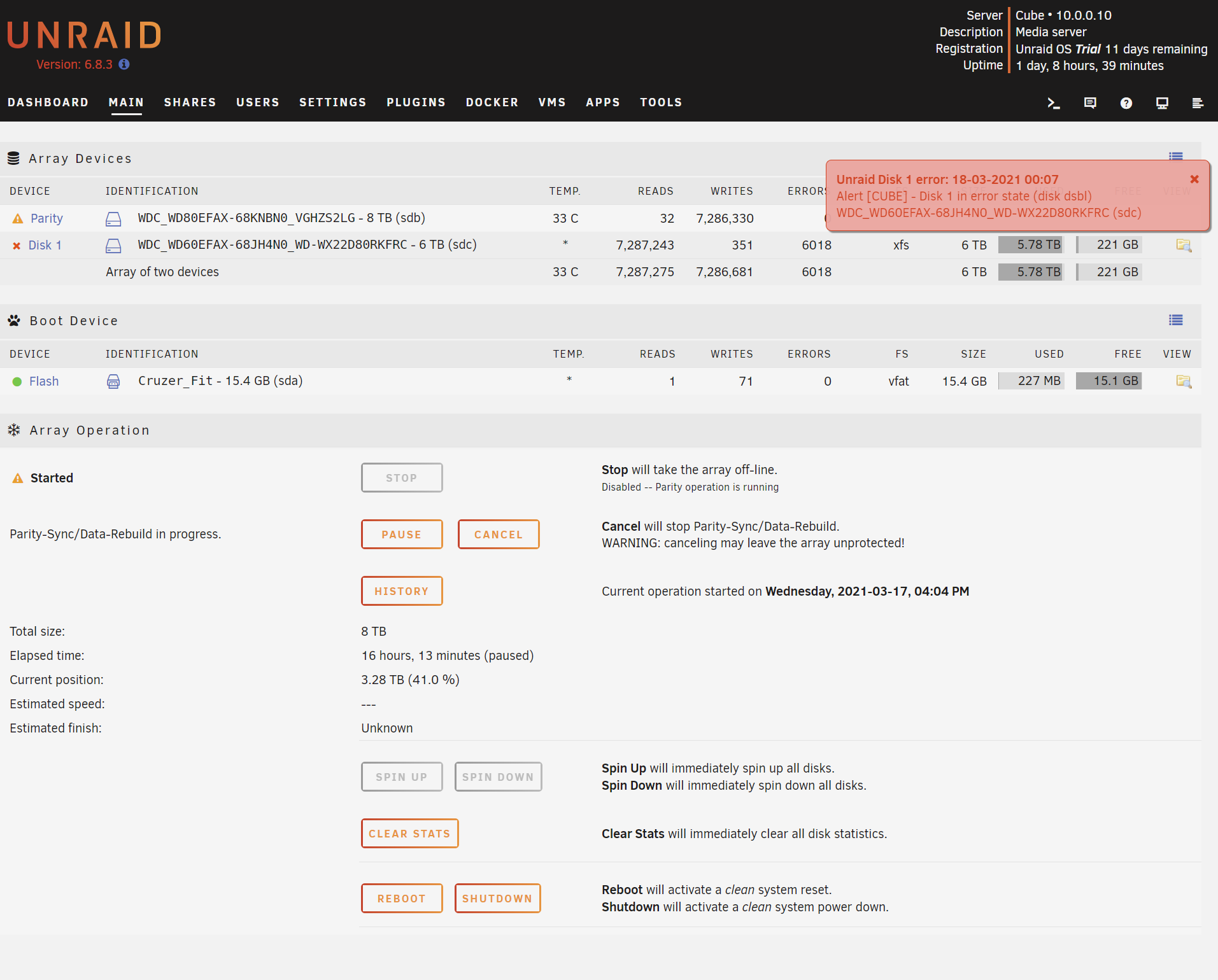

Bit of an update and further puzzlement: I've gotten the 6Tb drive replaced, and the tech at the store assured me that the drive was error-free. Great! Same thing he said about the original 6Tb drive. 🙄
So I installed the replacement 6Tb and, unlike the original one, unRAID was able to format it. Yay! Then, since I need the largest drive in the array to be the parity disk, I `rsync`ed everything from the 8Tb (which had everything `rsync`ed from the Drobo5N) to the replacement 6Tb. That process took about half a day, and completed successfully. I then created a new drive config (Tools -> New Config), and assigned the 8Tb as a parity disk, and the 6Tb as data. It started to rebuild the parity on the 8Tb, which it said would take about a day. So I left it like that last night.
This morning I come back to see that the process paused partway through, and there's an error notification on the screen:
If I click on the disk log, the modal window just loads screen after screen of log rows, with errors scattered everywhere.
At this point, I have no idea what to think.
Full diagnostic attached.
cube-diagnostics-20210318-0833.zip
