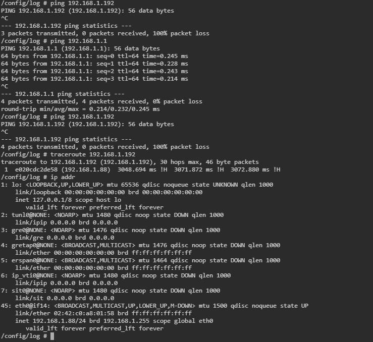

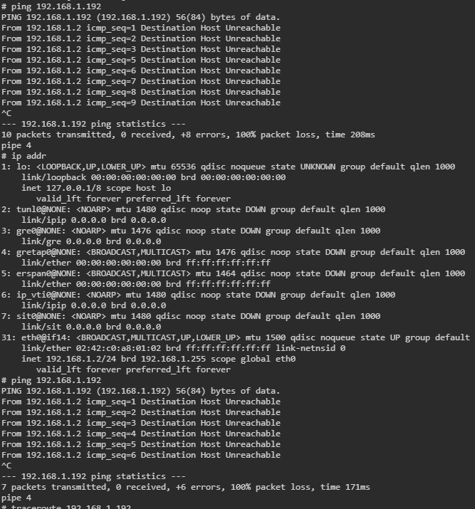

I have the problem, my dockers living in unraid with static IP in the LAN (they take IP from the router via network bridge) cant ping to unraid IP.
I can ping from my computer and others computers, but i enter in the console from dockers and cant ping the unraid IP.
I test it from diferents dockers, nginx proxy manager, and tautulli for example, cant ping to unraid IP.

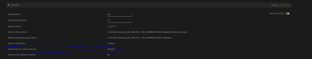

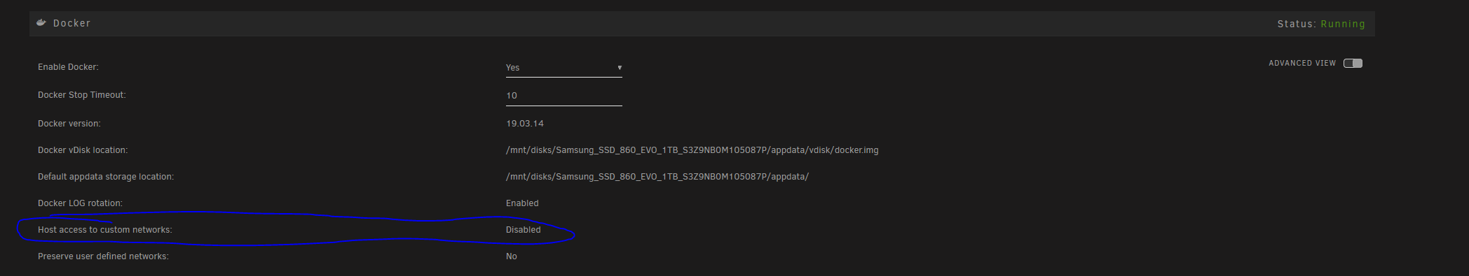

Okay, I think i know what happens.
Settings=> Docker => Advanced.
image.thumb.png.dbe43e0d8b0adc204f7394ab59f45f7d.pngs
