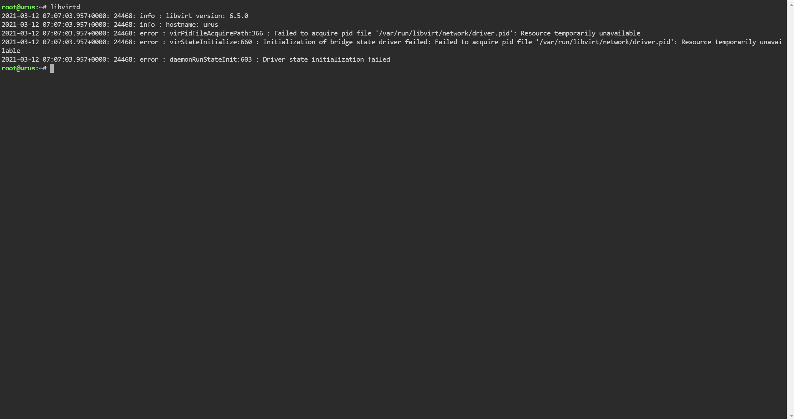

Libvirtd Issue - not sure how to resolve it.
Tried to use the virt manager docker as im having no luck with VMs on unraid & i got a error sayin that virtmanager could not detect the libvirtd service... and indeed :
How do I sort this?
Thanks.
Is the VM tab showing in Unraid?
If you run this command do you see that 'libvirtd' is running?
 ps -aux | grep libvirtd
If you need to interact with 'libvrtd' from the command line you should use 'virsh', e.g.:
virsh list --all
virsh list --all
Initially the two VMs that I had dissapeared after i typed 'libvirtd' into the console.
Did a reboot and the VM's are back.
So im guessing the service is running.
Have not had a chance to try the virt manager again yet.
