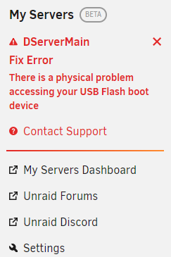

I've recently gotten this error message and now I am unable to access my server at all since it defaults from my local IP to the unraid-provided https IP.
Has anyone else had a similar error it?

1492335389_2021-04-2220_34_57-DServerMain_Dashboardand2morepages-Personal-MicrosoftEdge.png.88da1a9e9dee5bf85b41f88b4f222cd1.png
Your flash drive is failing and needs to be replaced. If you setup the Unraid.net flash backup you can follow the steps here: https://wiki.unraid.net/My_Servers#Restoring_Flash_Backup
