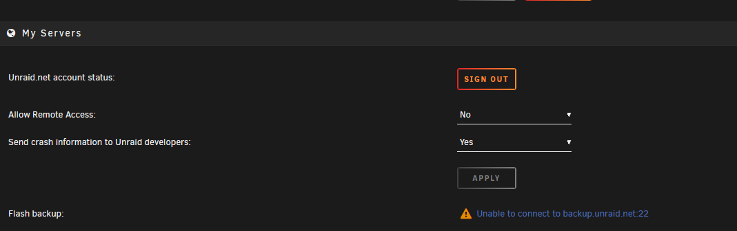

Hello,
since the last update my server overlay tells me the following inside managment access for the backup status:
Unable to connect to backup.unraid.net:22
On the other hand, inside my sever dashboard online, its telling that its connected. I tried unraid-api restart but that doesnt fixed that.
any suggestions?
Um running latest unraid version 6.9.2
Regards
Martin
Edited by mtinii
1 hour ago, mtinii said:
Hello,
any suggestions?
Regards
Martin
same problem here
same here on all my 3 servers.

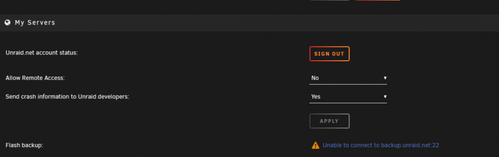

@ljm42
Same issue
3 hours ago, Dexter84 said:
same problem here
Flash Backup uses an SSH connection to store your backup in the cloud. For this to work, Unraid needs to be able to make an SSH connection on port 22 to backup.unraid.net.  Something in your network is preventing this, perhaps your router/firewall or possibly your ISP.
Previously this failed silently. In the latest release we now detect this situation and display a message. Until this is resolved, you will not be able to restore a backup from here: https://forums.unraid.net/my-servers/
Having said that, my systems are giving the same error this morning. Looking into it.
I'm getting same error "Unable to connect to backup.unraid.net:22".  I don't see anythign obviously wrong anywhere in my firewall.
