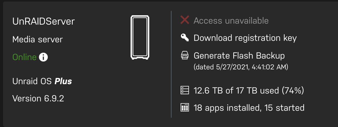

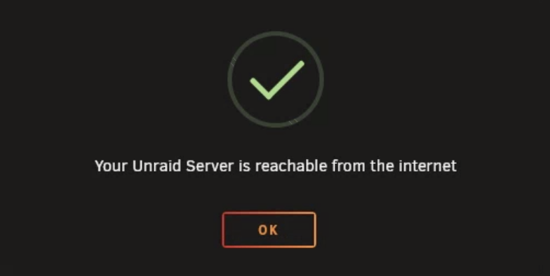

It was working for a while, but now I cannot seem to get remote access working.
Port is forwarded. The check passes. It shows that it's connected to the mothership and I've since rebooted the server.
Any ideas?
Any ideas?
Everything in those screenshots looks good! Only one thing I can think to check if you reload the Settings -> Management Access -> My Servers page, is "Allow Remote Access" still set to "Yes"? It is possible that you can set it up, test the connection, but not hit Apply, in which case the change will not be saved.
It was set to "Yes", but I did a No > Apply, then Yes > Apply and it seems to be working.
Thanks!

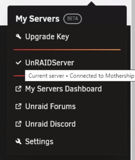

Any idea what this is? (pic)
Flash backup works when reinitializing My Server, dashboard shows as offline which it's not?
