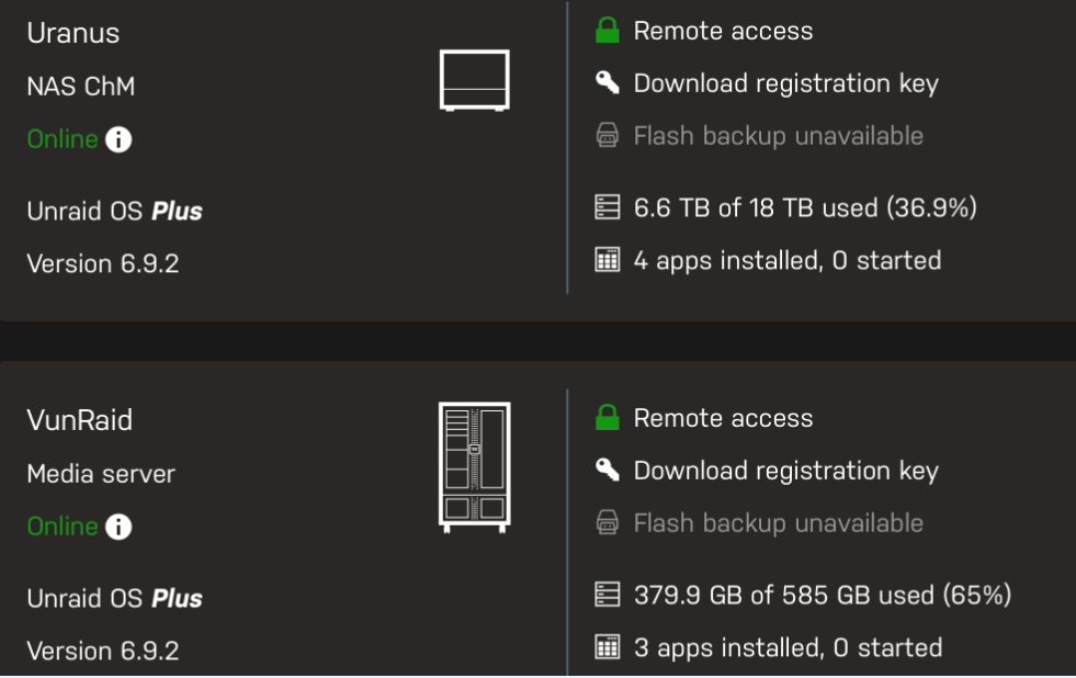

Hi @ljm42,
I am more or less in the same situation than @cycodrama, with flash backup not available on both of my servers.
I have
and
I tried
- update
- changes
- deactivate
- reinitialize
No success
Signed out, uninstall My Servers plugin, reboot, install again the plugin, then sign in, reboot.
Still no success
On 6/22/2021 at 10:47 PM, ljm42 said:
Please PM me your /var/log/gitflash file. The easiest way to get it is to open a web terminal and type:
cp /var/log/gitflash /boot
Then attach the gitflash file from the root of your flash drive.
I enclose my dignostics file and PM the gitflash file to you.
I find strange that I get the same behaviour on both servers.
Thansk in advance for your help.
Chris
uranus-diagnostics-20210627-1128.zip
14 hours ago, Chris Mot said:
I have
This means flash backup is setup, but there are changes which have not yet been saved. If you wait one minute it should change to this:
Can you let me know what happens after you have left it alone for a bit? If it still says "Not up-to-date" please send me a new gitflash, without pressing deactivate/reinitialize/etc. I need to see if there are any new entries in the file from just normal usage. Thanks!
Unfortunately 19 hours later I am still at
I didn't press any button in the "My Severs Flash" section.
I PM'd you the latest gitflash.
