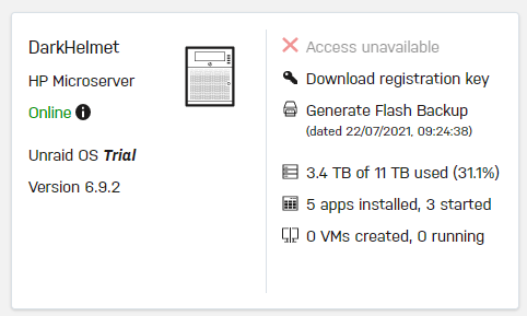

Is there a way to realize remote access for two or more Unraid servers in the same local network?
What I did:
Router (WAN > LAN):
tower port 1441 > 443
tower2 port 1442 > 443
Tower (Management Access):
use SSL/TLS auto
Port 1441
Tower2 (Management Access):
use SSL/TLS auto
Port 1442
Seems that you expect 443 for remote access and 1441/1442 for local access. This would be a no-go for two or more servers in one local network. Is there a different way to get this working.
Absolutely!
Not quite. The local access ports for each server can be the same. The remote access ports have to be different since each port can only be used once on your router.  Here is an example:
Go to Settings -> Management Access -> HTTPS port
* server 1 - port 443 is the default but you can choose any other port that is unused on this server. If you don't use the default I'd recommend something like 3443, 4443, etc. For this example I will use 3443.
* server 2 - port 443 is the default but you can choose any other port that is unused on this server. It is on a different IP address, so it can be the same port as server 1. For this example I will use 3443 as well.
Then go to Settings -> Management Access -> My Servers -> WAN port
* server 1 - I recommend you choose a high port that someone is unlikely to guess, let's say 35821. It must be a port that is not already port-forwarded through your router.
* server 2 - Choose another high port. It must be different than server 1's WAN port and different from anything else that is already port-forwarded through your router. For this example how about 29703.
Setup your router to port forward:
35821 -> server1ip port 3443
29703 -> server2ip port 3443
Hmm, does not work. I used 1443 internal for all servers and WAN ports 31140, 31141, 31142. Everything is setup in the Router. Hitting the Check button shows reachable from the internet.
But My Servers dashboard shows unavailable for all servers. And using the WAN ports with the cryptic unraid.net URLs does not connect to the servers. Only the LAN ports work within my LAN.
Any ideas?
Any ideas?
If the "check" button works on all servers then your ports and port forwarding are all good.
Does the My Servers Dashboard say your servers are Online or Offline? If they are Offline then the Remote Access url is going to be "access unavailable".
If they are Offline, you may be able to bring them online by opening a web terminal and typing:
  unraid-api restart
https://yourpersonalhash.unraid.net : HTTPS_PORT will work inside your network
https://www.yourpersonalhash.unraid.net : WAN_PORT will work from outside your network (in order to get the external url to work inside your network you need to enable hairpin routing in your router. Many routers do not support this)
Restarting the API did the trick. Thanks.

Any idea why a server would be showing as "Online" but not able to remote access? Its config is (seemingly) identical to my other server which is playing nicely. The only difference is that this one (as you can see) is still a trial version - is that a thing?
