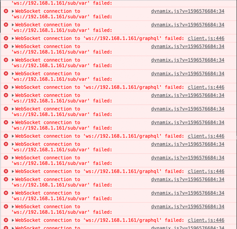

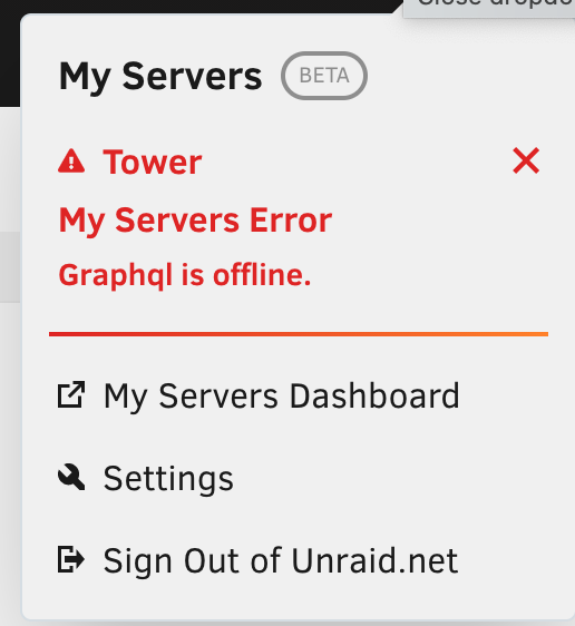

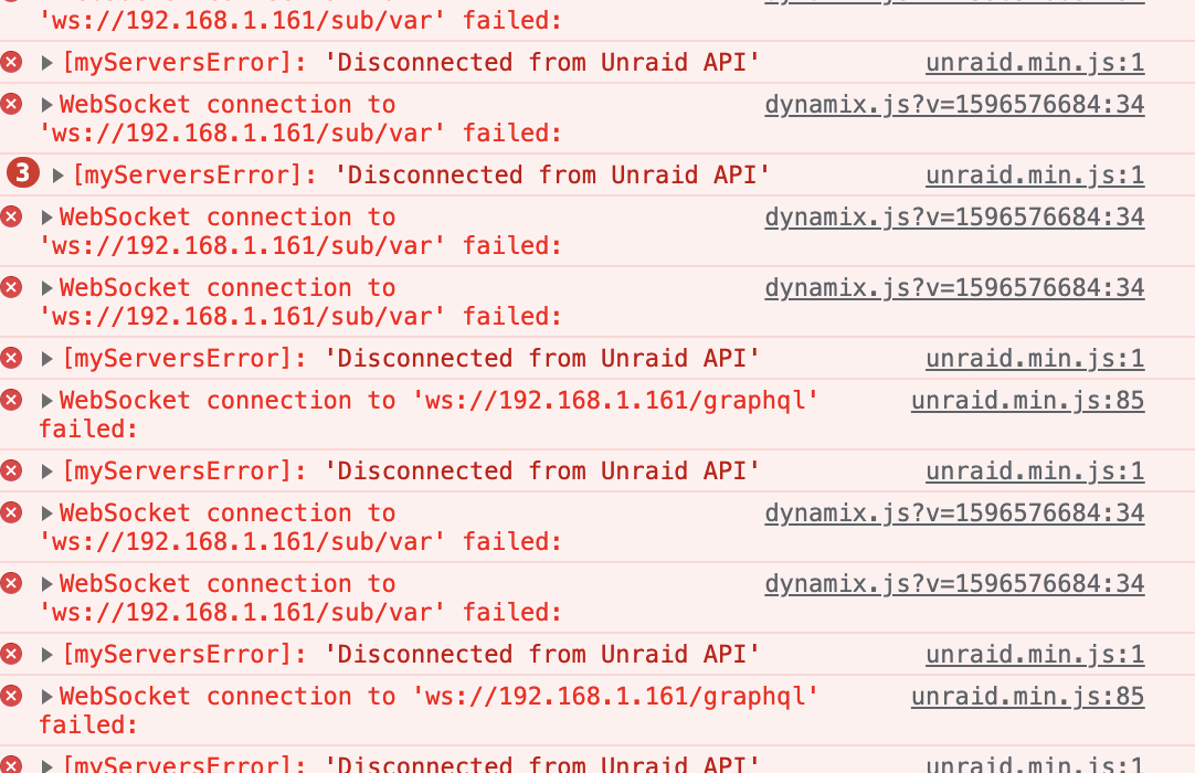

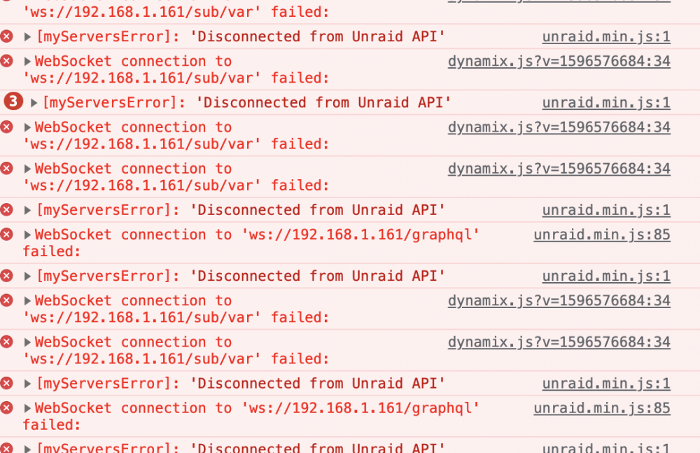

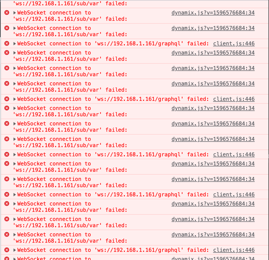

Update: This problem was unrelated to MyServers plugin, this was just a symptom. My nginx was having issues and filling my logs, so I did a "/etc/rc.d/rc.nginx restart" and it seemed to resolve it thanks to this post:

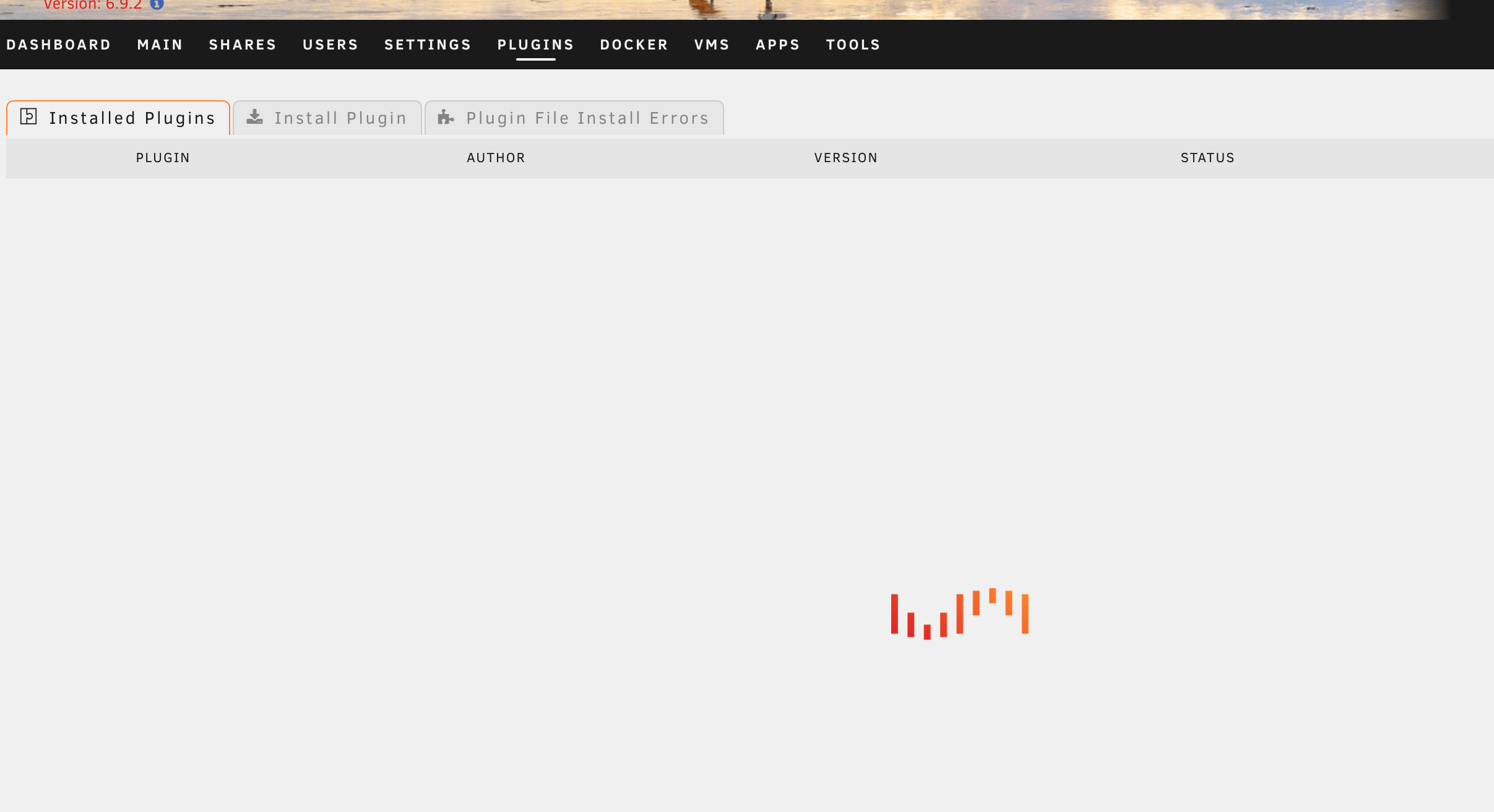

I'm having tons of issues with accessing my WebGUI.. I'm not sure if it's related to the MyServers plugin or not but I'm seeing this:
In console I'm seeing this:
The WebUI just shows a perpetual loader:

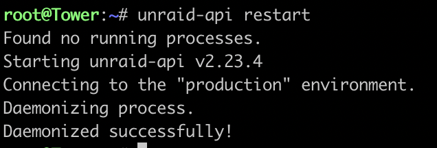

I did an "unraid-api restart" and got this:
Unfortunately no change. In console I'm seeing this still:
Edited by tmchow
Thanks for posting this follow up! I was struggling to come up with a fix.
