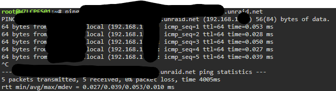

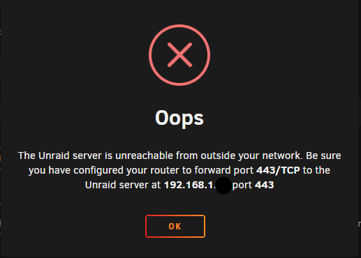

Fresh started twice.(once before this, once after you asked)
curl results:
Ping result:
Check Result:
Port Forwarding configuration:
curl results:
Ping result:
It looks like you ping'd the internal host, please ping the external host (has 'www' up front):
ping www.yourpersonalhash.unraid.net
you want to confirm that the external host IP matches the 98.1.x.x IP address you got from the curl command.
Also, I'd really recommend that you use something other than port 443 as the WAN port. In the docs we say "We highly recommend you choose a random port over 1000 rather than using the default of 443. i.e. something like 13856, 48653, etc"

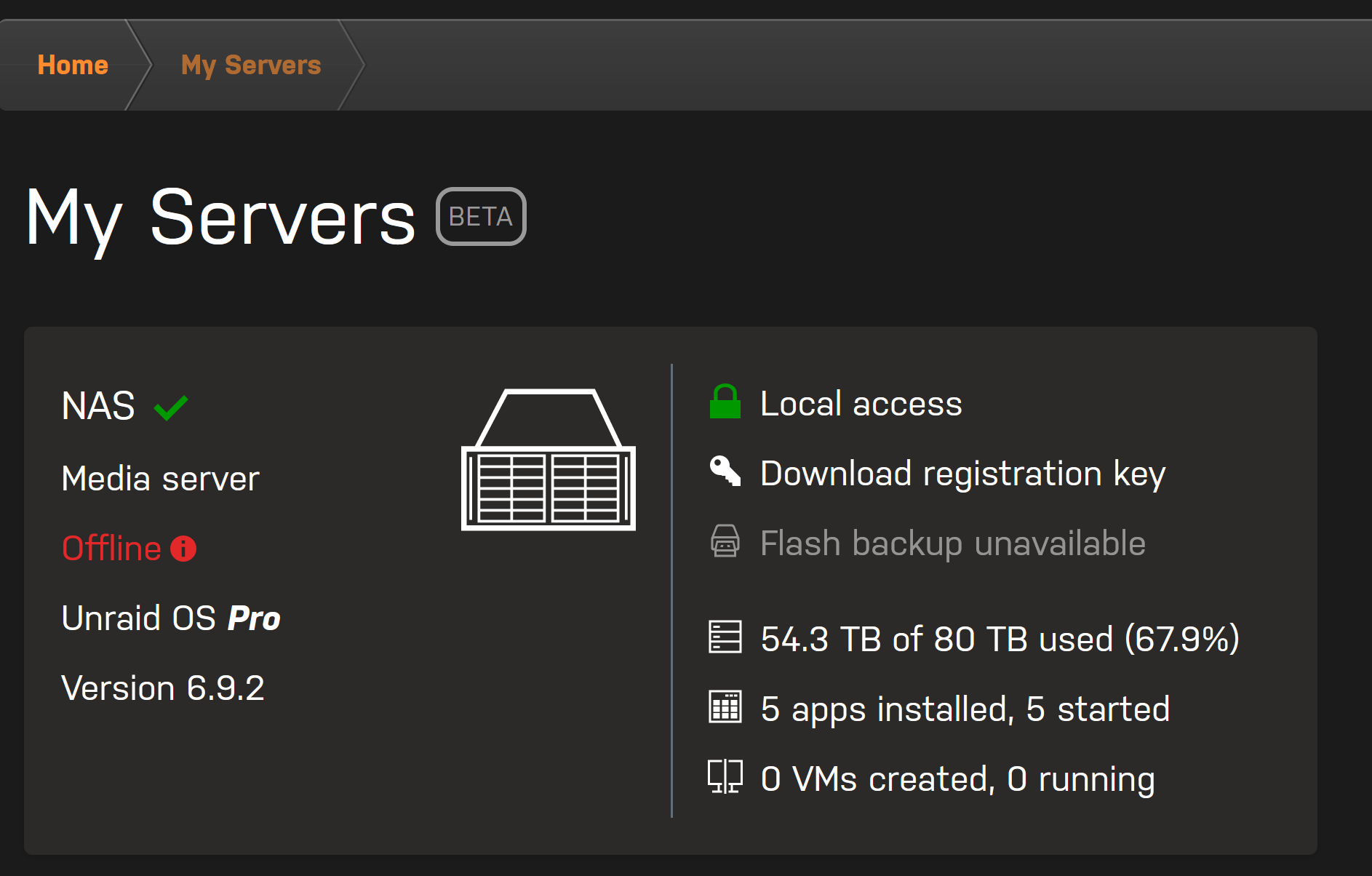

I like to pop in here from time-to-time to see what's been happening. I decided to check My Servers on this site, and I'm seeing this:
It's showing Offline, but I can access it remotely just fine. Is this a bug, or should I do something to fix this on my end? My Servers is working for me, so not the biggest deal, but I was surprised to see that the thing that is working is telling me that it isn't working.
Also, is there any ETA on encrypted Flash backups? I don't use the online backup solely because I don't want unencrypted data floating out in the ether. This isn't something I'm hugely upset about or anything, but merely curious on where the Unraid team is at with this.
As a side note: Thanks for everything! I love being able to access my server wherever I am. It's super convenient, and I appreciate all of the effort put into this.
Thank you for the kind words :)
The connection that allows the dashboard to show how many apps are installed/started, vms created/running, etc has gone offline. You can bring it online by opening a webterminal and typing:
  unraid-api restart
We are readying a new release that will hopefully resolve this.
