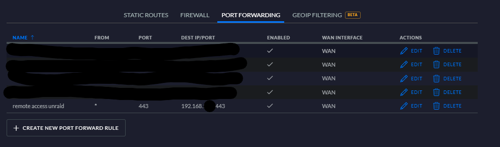

Currently my server is port forwarded - open port check success.
Allow remote access - yes
Obviously signed in already
When I go to https://forums.unraid.net/my-servers/
It shows access unavailable.
2 hours ago, ljm42 said:
So you successfully setup local SSL and are accessing the server through https://yourpersonalhash.unraid.net , correct?
And now you trying to enable Remote Access, but when you press "Check" it gives an error?
This means either:
1) DNS for www.yourpersonalhash.unraid.net is not resolving (note the "www" up front, this should resolve to your external IP)
2) or your port forward is not working
Reinstalling the plugin will not help, nor will restarting the api :)

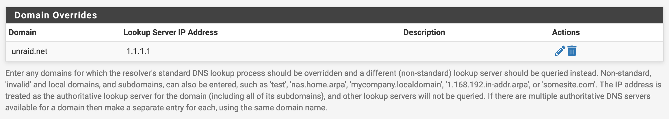

I installed the plugin on both of my servers. When I went to Management Access under settings, my initial attempt to provision the Let's Encrypt certificates failed, indicating that it was likely my firewall's DNS rebinding protection.
To resolve the DNS rebinding issue I went into my firewall config (pfSense) and under DNS Resolver I added the unraid.net domain to the 'Domain Overrides' section. One thing I'm not sure about is where pfSense asks me to provide the DNS 'Lookup Server IP Address' so I just set it to a Cloudflare one for now, as shown on the attached pic. Cloudflare resolves unraid.net so I suspect I'm correct.
Then, with the DNS rebinding check corrected, I was able to provision the Let's Encrypt cert for both servers. I then enabled remote access and the flash backup. Flash backup is working for both servers. I also chose custom ports for each server and added port forwarding rules for them to the firewall.
When I attempt the Check function, both servers respond with the 'Oops This Unraid Server was unreachable from the outside' message. When I go to the My Servers Dashboard, one server shows that it has Remote Access but choosing it ends up at a browser window/tab that eventually times out before displaying the unRAID webgui. The other unRAID server still shows with a red X and 'Access unavailable'.
Not sure what to try next other than the full reset procedure, which unfortunately takes time to ensure reset of user account passwords. That and it's Saturday night so the Plex server is a little busy with users. Any other suggestions?
The help text in the webgui says:
If you are using pfSense internal DNS resolver service, you can add these Custom Option lines:
server:
private-domain: "unraid.net"
So I am not sure exactly what your screenshot is showing or what the DNS 'Lookup Server IP Address' Is.
But, you are not being hit with the DNS Rebinding issue so if you are happy with the setup that is fine.

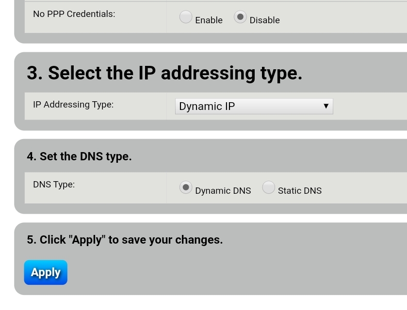

Just a heads up. I couldn't get it to provision on my server. I went into my router and changed the dns room static to dynamic and then it worked. So maybe that will help someone else.
I'm glad you got it! But I'm not sure what static vs dynamic dns is, can you post a screenshot? Also, what kind of router?

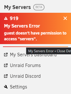

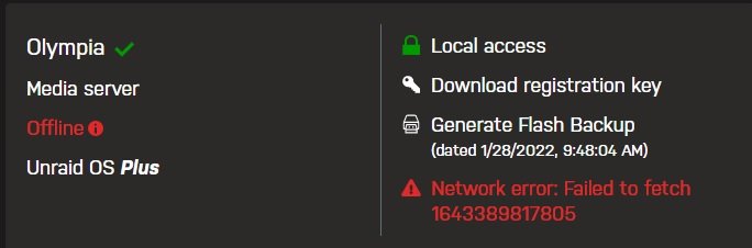

20 minutes ago, ljm42 said:
Click on your username in the upper right corner of the webgui, can you post a screenshot of what it shows?
It's like it's saying the guest user doesn't have access.
I don't have a user called guest though.
It's a crappy actiontec c1900a modem/router from centurylink.
Sorry you got "lucky" and hit a bug :) This is on the top of our list to track down.
Please open a terminal window and type this:
unraid-api restart
When the API restarts it will hopefully make a connection and then from the My Servers Dashboard you should have options for "Local access" or "Remote access" instead of "Access unavailable"
6 minutes ago, DevXen said:
It's a crappy actiontec c1900a modem/router fronlm centurylink.
Is this talking about DHCP? I'm honestly quite confused how this solved your DNS rebinding issues :)  But I'm glad you got past it!
unraid-api restart
Brilliant - that fixed it.
It's not DHCP i am not sure but i think the issue waa my router won't let me loopback to it. So like i have swag setup i can't access it from my local network if i use the domain i setup. No i have to use my internal ip. And that's true for any Internet facing service that runs on my server. But again my router sucks. So i assumed that was the dns binding issue and saw i could change my dns to dynamic and hey it worked.
