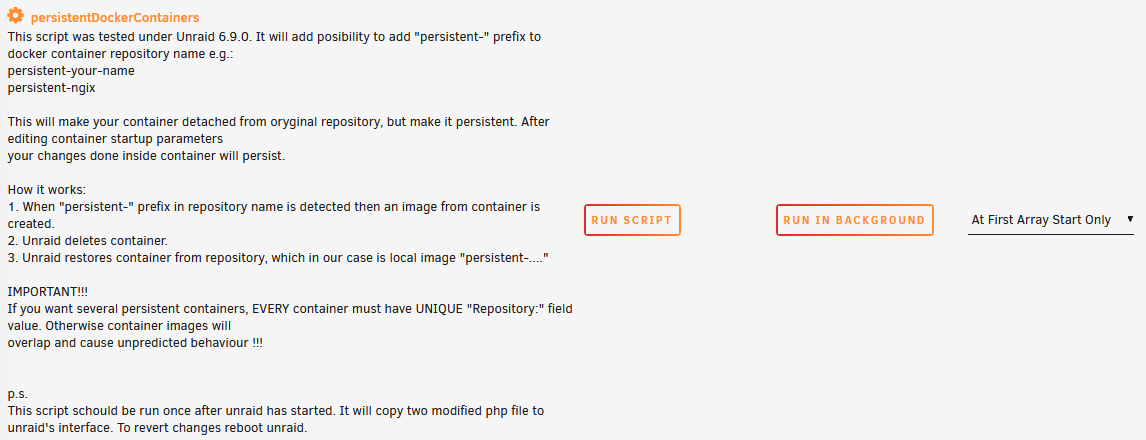

For this reason I have created small feature for unraid to make container persistent. Unraid is working in agreement with docker philosophy, therefore at any parameter change in unraid’s gui or when update is released it will erase whole container and recreate it. My code makes container detached from main repo and persistent across parameter edit.
To make it work user.script plugin is required. Then my script should be copied to folder “/boot/config/plugins/user.scripts/scripts/persistentDockerContainers” and scheduled to be run once after array is started.

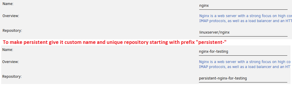

How to use my code?
You need to edit repository field, by adding “repository-“ prefix. Each container that is used as persistent should be having unique repository field !!! It is also advised that name of the container should be changed to unique, because unraid has undesirable behavior that, when another container is installed via community apps and container with the same name exists it will be deleted without any warning.
In short, to make container persistent:
1.       Change name to something unique.
2.       Set unique repository name starting with prefix “persistent-“
