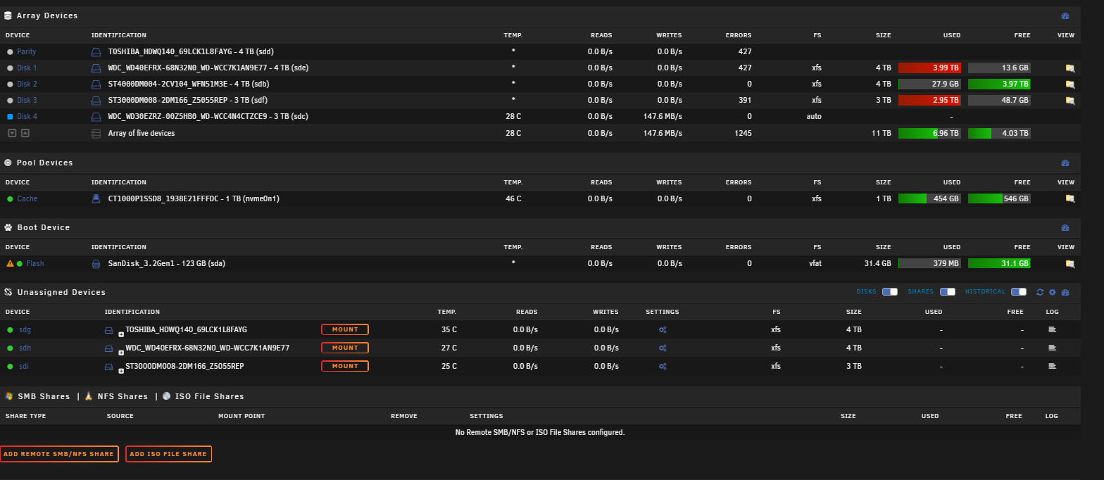

I had 4 drives plugged into my MB working fine. I added a HBA card and moved them over. One of my disks became disabled. I did the procedure for re-enabling it but that didn't work. So I added a new drive and did a parity rebuild. Then that drive is showed unmountable. So I did a drive format thinking I would only loose the data on that one drive. I did the format and then a parity/data rebuild.
Now all my drives are mounted okay but there is nothing in any of my shares (other than ones on the cache pool). If I go to root/media/user the shares are there but empty. If I go to each disk root/media/disk1 the folders in the shares are there but no files.
The dashboard shows the drives are still full.
My dockers have gone but the appdata folder and docker.img are on my cache drive.
Any ideas on what to do?
I didn't mind loosing one drive worth of films but now all my data is unreachable.
For some reason my drives are also in unassigned devices?
