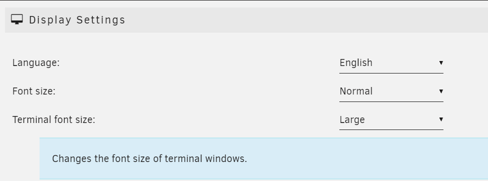

October 12, 20224 yr Author 3 hours ago, Dragons Advocate said: Same here, deactivating Brave Shield fixed this. BUT: Can we please agree that disabling security features just to fix a cosmetic bug is NOT acceptable? I am more interested in what caused the issue in the first place, that security shields could have caused this? Is there some weird loading order that tries to get fonts from external sites or something like that? That shouldn't be necessary any longer beginning with 6.10. You can adjust it here:
October 13, 20224 yr 13 hours ago, dlandon said: That shouldn't be necessary any longer beginning with 6.10. You can adjust it here: Pretty sure I saw this issue with 6.10 as well. The first thing I tried was adjusting the font size in display settings.. didn't correct the problem. I had to disable the duckduckgo extension to fix the weird font display issue. Not sure why the duckduckgo extension caused that, but happy to have the font look good again!
