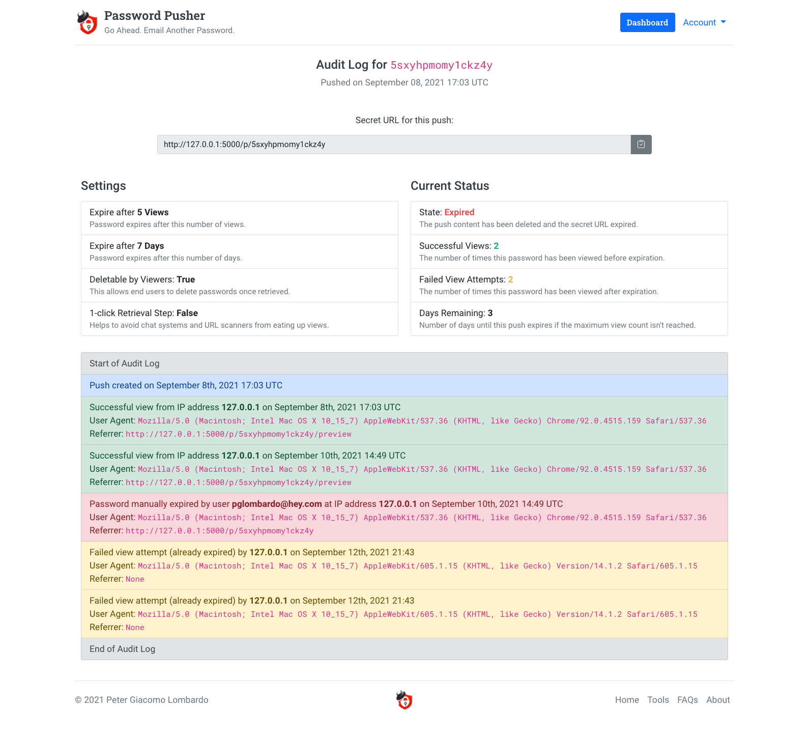

Hello Unraid community - just a quick update that Password Pusher now bundles 26 themes in the application:
See the gallery of themes here.
To select a theme with the latest version, just set the following environment variables:
PWP__THEME=<theme-name>
PWP_PRECOMPILE=true
This is in addition to branding to change logo and site name.
The application now also supports File and URL pushes.  Push files and URLs that expire same as password pushes do.  Audit logs included.
Any trouble or issues - let me know!
Best/Peter Giacomo Lombardo

In Unraid is their a trick/way to get the time to report correctly as far as in the AUDIT Log? When I have a log the time stamps do NOT match; about 5 hours off.
The times are always shown in UTC currently.  There is a feature request filed to display timestamps in local timezone.  When that feature is delivered in a future version, it'll show up automatically for users.
User preferences are being worked on now (to save default expiration settings and more) - there will be an option to set preferred timezone.
I hope this helps!
Best,
