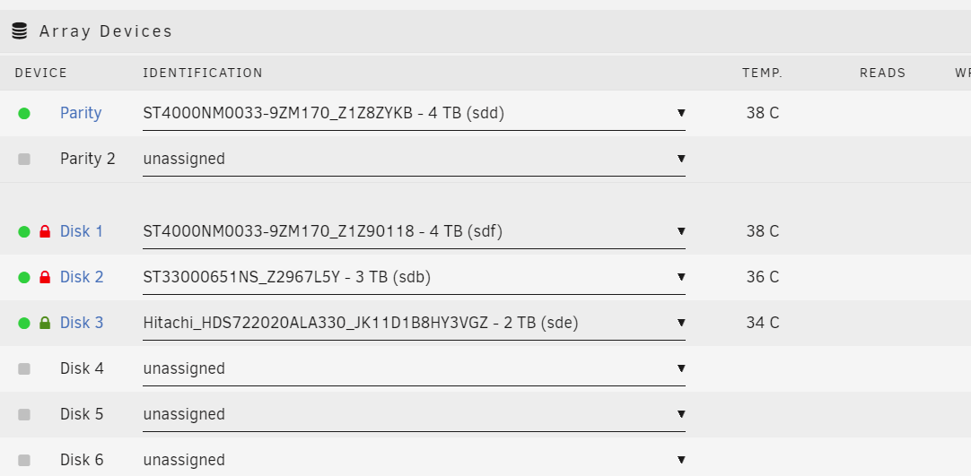

Hi, after doing a memtest86+ (6.9.1 integrated one) and connecting a cache device to the server and starting it up, I was presented with 3 disks unable to decrypt. See picture 6.9.1 wrong encryption key.PNG

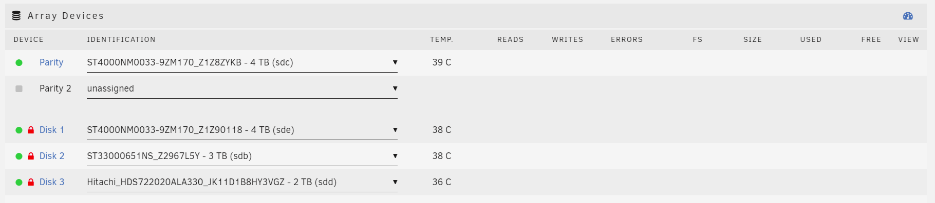

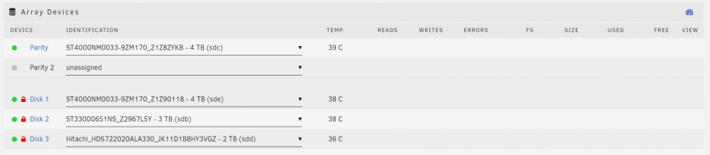

After downgrading to 6.8.3 it was showing that two disks are unmountable and one is encrypted. See picture 6.8.3 one encrypted.PNG.
I thought that maybe I was really entering the wrong decryption key.

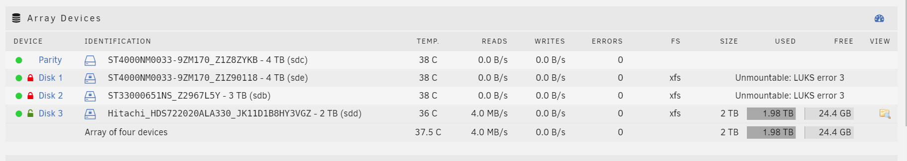

However, after a couple of tries it successfully mounted disk No 3 as seen in Picture 6.8.3 only one drive unlocked.PNG
The disks are nearly full, 20GB space left
What can I do to get access to disk 1 and 2?

I solved it! It had insufficient RAM to unlock the drives. I was downgrading it to 2GB RAM and that causes the inability to unlock the drives. I'll report the proper authorities to update the system requirements as it is not listed that LUKS requires more RAM to run
