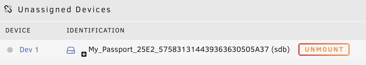

I have a USB drive (sdb) mounted with UD:
1658500954_ScreenShot2021-03-16at3_10_21PM.thumb.png.a712a2da7e8772bd01b300265865cb46.png
v6.9.1 spins it down correctly but the (substandard) interface returns bad/missing sense data:
root@NAS:~# hdparm -y /dev/sdb
/dev/sdb:
issuing standby command
SG_IO: bad/missing sense data, sb[]:  f0 00 01 00 50 40 00 0a 80 00 00 00 00 1d 00 00 00 00 00 00 00 00 00 00 00 00 00 00 00 00 00 00
...which this line in /usr/local/sbin/sdspin catches and records as an error:
  [[ $RET == 0 && ${OUTPUT,,} =~ "bad/missing sense" ]] && RET=1
So although the drive's spun down unRAID thinks it isn't causing (a) the activity LED to stay green and (b) unRAID to try to spin it down every spindown interval.
I've worked around it by modifying the code (below) to exclude USB drives from the test.
Is that risky, should I not have?
I'm not sure what cases this test is meant to handle.
