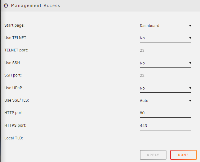

Why is this a problem? Only because you know my forums username, you are not able to login. There is one magic thing missing, the password. Lets say you change the username to something else. What happens? The attacker tries a different one. By that you don't stop the attacks. They will happen all the time if you connect a device directly to the internet. They won't even stop if you close all ports. The only difference is, that they are not logged anymore.
1 hour ago, Port22_Login_root_ScanBot said:
The outside attempts to breach the 55,000 open ports on my end...
There are not "55k" open ports. Unraid is based on Linux and Linux does not have any open ports as long there is no service listening to it. This means the Unraid webserver listens to Port 80, so its open. If you enable SSH, which can be by the way disabled, SSH will listen to port 22. You don't want to use port 22 for SSH? Then change it:
Finally its your decision to open ports, enable SSH and make it available through the internet.

If you close port 22 (ssh) and open port 51820 (wireguard), you finally have exactly the same amount of open ports, but with a different service listening to it. By the way: An open port is not a security breach, its absolutely necessary for networking.

Here are some facts about unRAID that will hopefully be helpful to you:
1 - unRAID is not a full-fledged Linux OS.  It is a very stripped-down version of Slackware Linux and only contains the necessary pieces to run the unRAID NAS appliance
2 - unRAID has no firewall capability and has NEVER been advertised as a secure, Internet hardened operating system.  It should not be exposed directly to the Internet
3 - unRAID cannot be exposed to the Internet via the default installation of the OS. As @trurl has pointed out to you, something in your router configuration has been done to expose your unRAID server to the Internet
4 - There are many secure ways of accessing your server over the Internet.  WireGuard is one of several and happens to be built into unRAID.
5 - The "root" user allows local GUI and terminal access. It should always have a secure password. The GUI is not intended to be accessed directly via the Internet.
6 - There is not really the traditional users concept as exists in other OSes as they are not really necessary.  You can control access to unRAID shares in a certain way via additional users/rights settings
7 - Port forwarding/opening ports (assuming it is done in the correct way) is not a huge exposure risk and is necessary for the WAN/LAN interactions need to allow secure remote access and services.

2 hours ago, mgutt said:
Then change it:
Thank you, mgutt
Buttoning that 22 down in favor of wireguard
Maybe a temporary solution as long you can't influence what your router is doing:
- open the WebTerminal  (The >_ in the upper right corner)
- execute this:
iptables -A INPUT -s 10.0.0.0/8 -j ACCEPT
iptables -A INPUT -s 172.16.0.0/12 -j ACCEPT
iptables -A INPUT -s 192.168.0.0/16 -j ACCEPT
iptables -A INPUT -s 127.0.0.1 -j ACCEPT
iptables -A INPUT -j REJECT
It will enable the "firewall" which allows only local access to the server. Not sure if this breaks other things like DNS resolution?!
Note: This is not permanent. It will be deleted on server reboot. If you want it permanent, add a script to the user scripts plugin or add it to your go file with the config file editor plugin.
