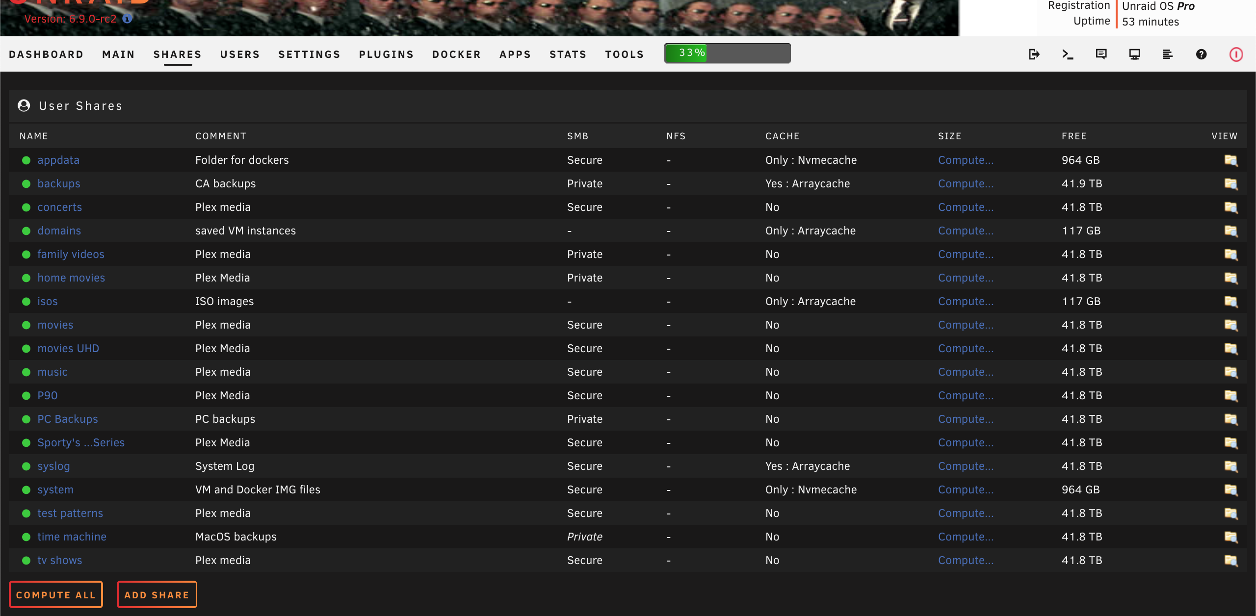

I thought I got everything lined out, but when I access the unraid shares from a Windows 10 pc, I don't see cachepool>'shares' and array 'shares'. I only see 'shares' which includes shares that are on both the array and the cache drives. Is this different in 6.9?? Because in previous Unraid versions, when I used windows explorer I could see array shares and my cache drives. I would then open the cache drive folder and it would show the cache drive shares.
I gave up on trying to figure that out, mostly because my dockers were working and the share were listed as being on the cache drives, when looking at the shares page.

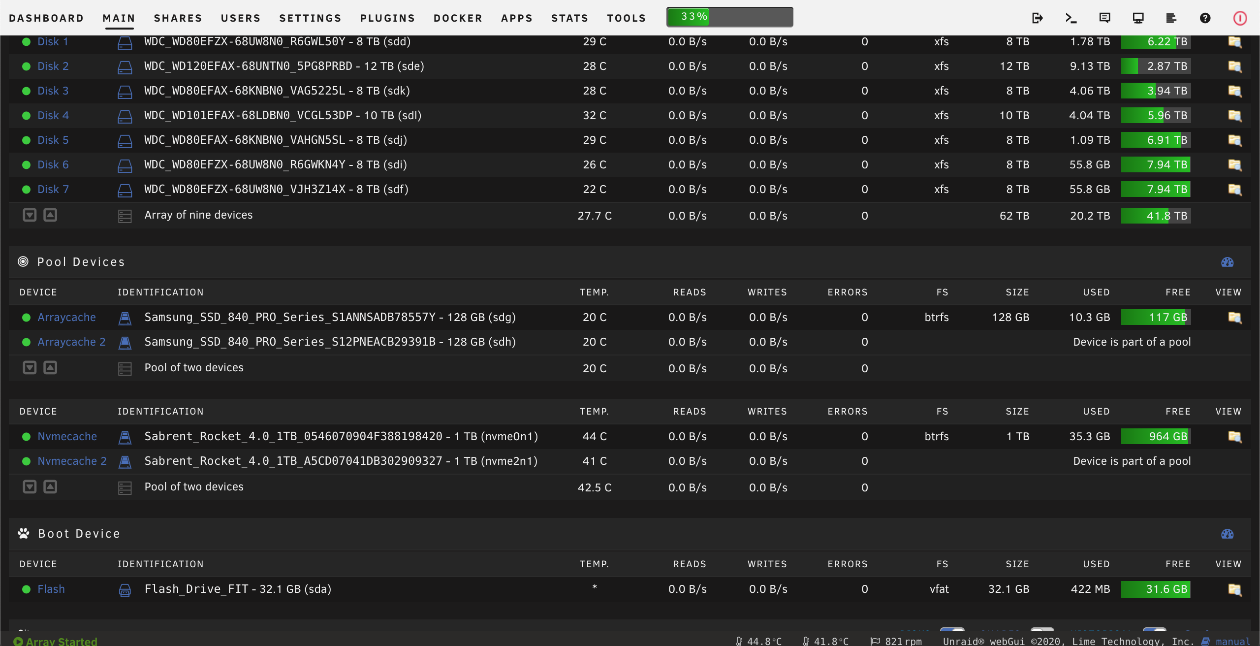

Now I'm trying to replace my cache drives with nvme drives and ran into another problem.

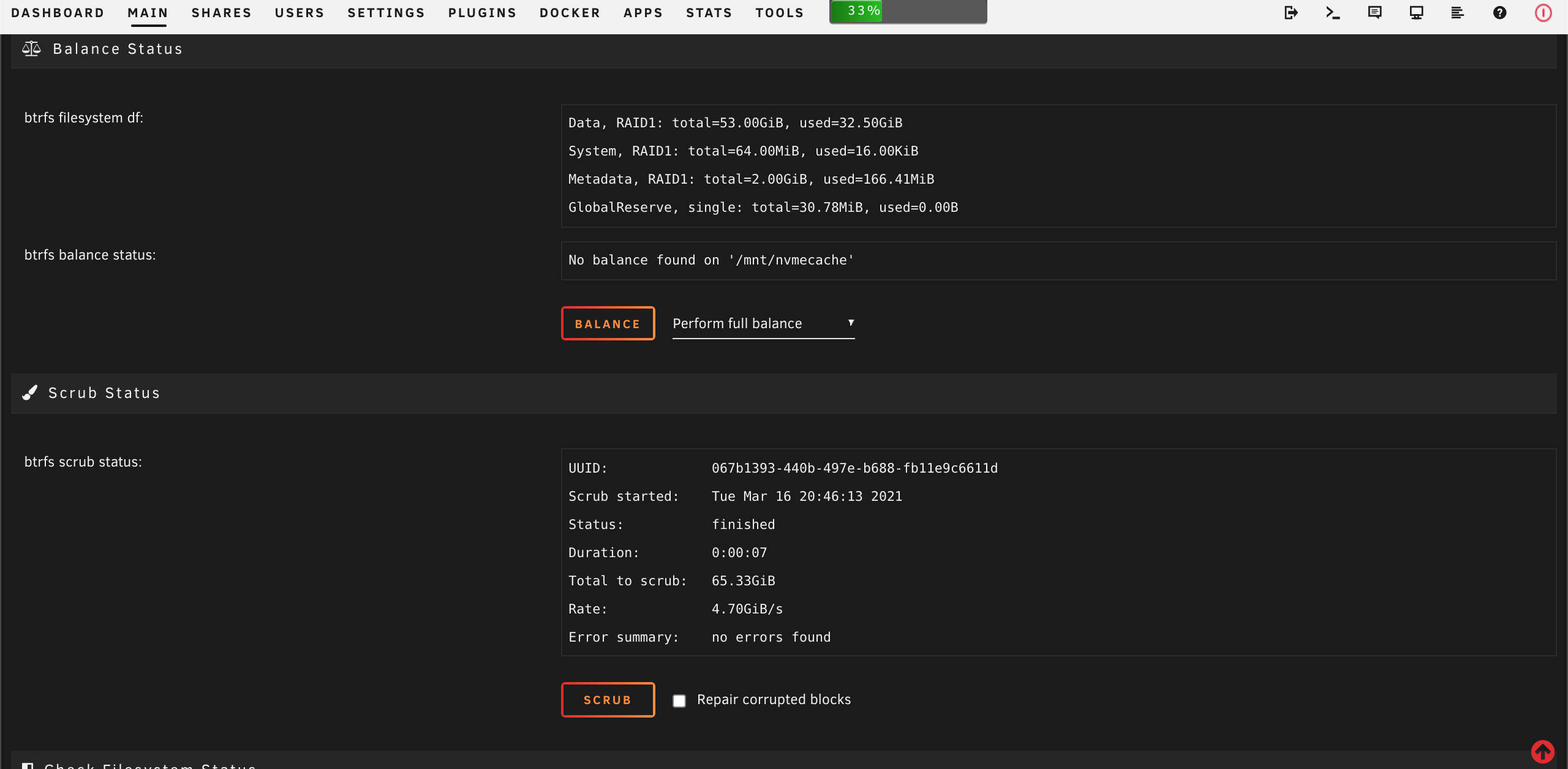

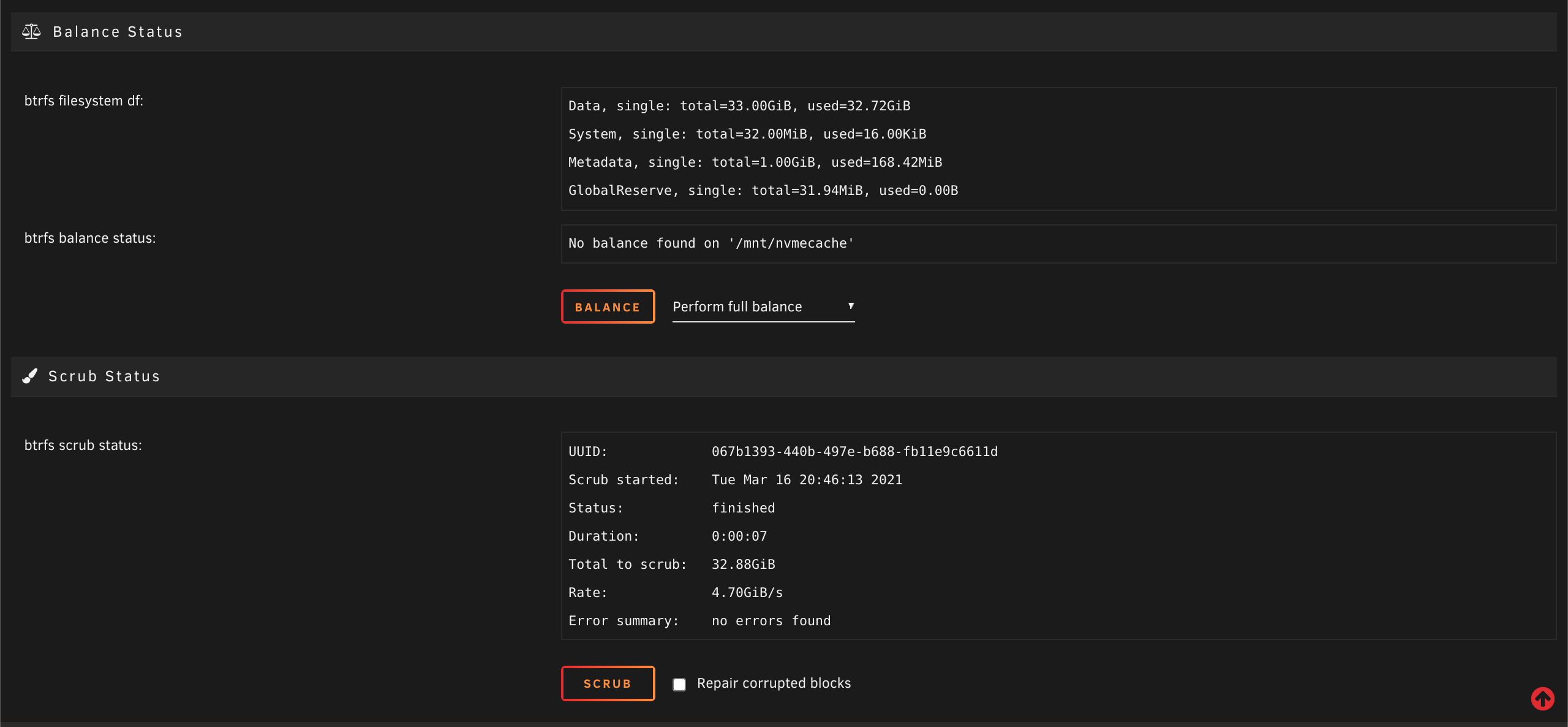

I have two cache pools (arraycache and nvmecache). For what ever reason, I can not balance the nvmecache drives to Raid-1. nvmecache is currently in single mode. My arraycache drives are balanced to Raid-1. I'm getting a lot of these log errors: invalid convert data profile raid1 and invalid convert metadata profile raid1 when trying to balance the nvmecache.
That's normal and how it always been, you can enable disk shares to see them.

Despite what the GUI shows pool is currently using a single device:
                  Data     Metadata  System
Id Path           single   single    single   Unallocated
 2 /dev/nvme0n1p1 33.00GiB   1.00GiB 32.00MiB   897.48GiB
Stop the array, unassign the other device (nvme2n1), start array, stop array, re-assign that device, start array, if successful it should auto balance to raid1.
This worked. Thank you so much.
