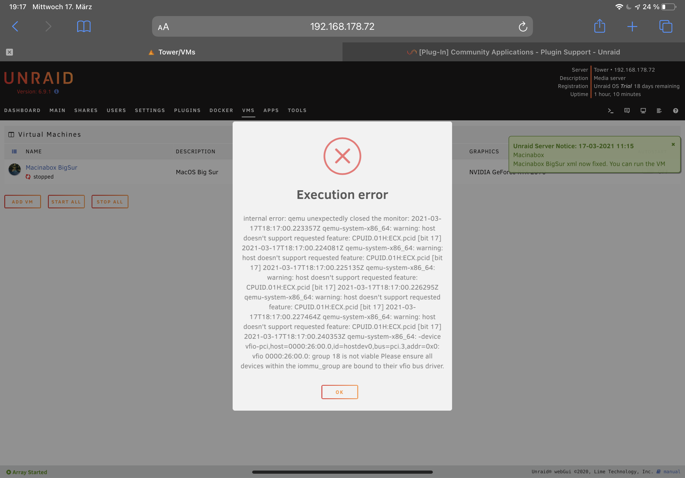

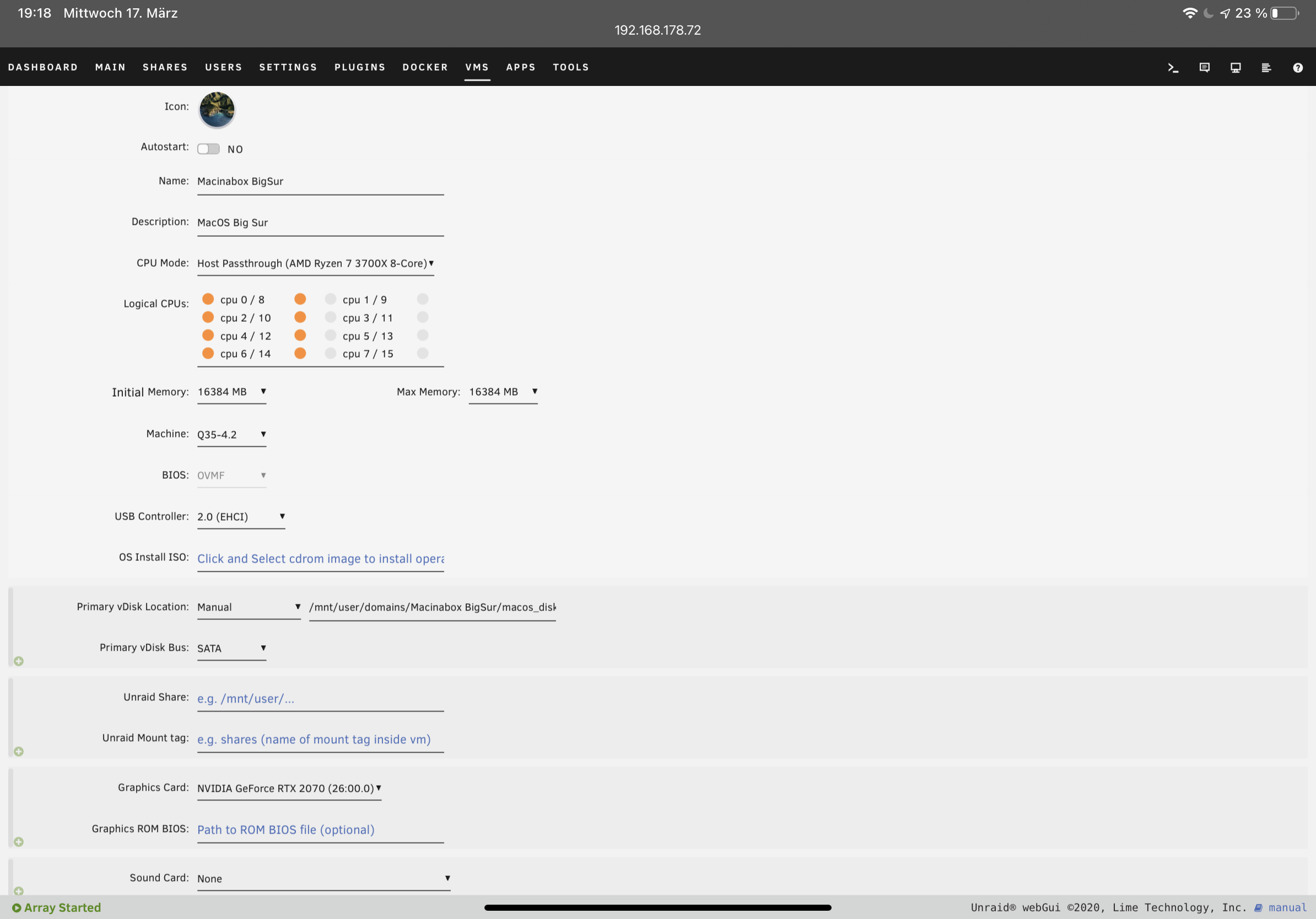

i just want to setup a macinabox VM. I followed every single step in Spaceinvader One‘s video but i am unable to start the vm after I installed the OS and changed the amount of cores. I attached the error message and config.

Your issue is related to vfio and gpu, the message is self explanatory; don't bother the pcid warning messages.
Anyway, RTX 2070 is not supported by mac os (any version).
