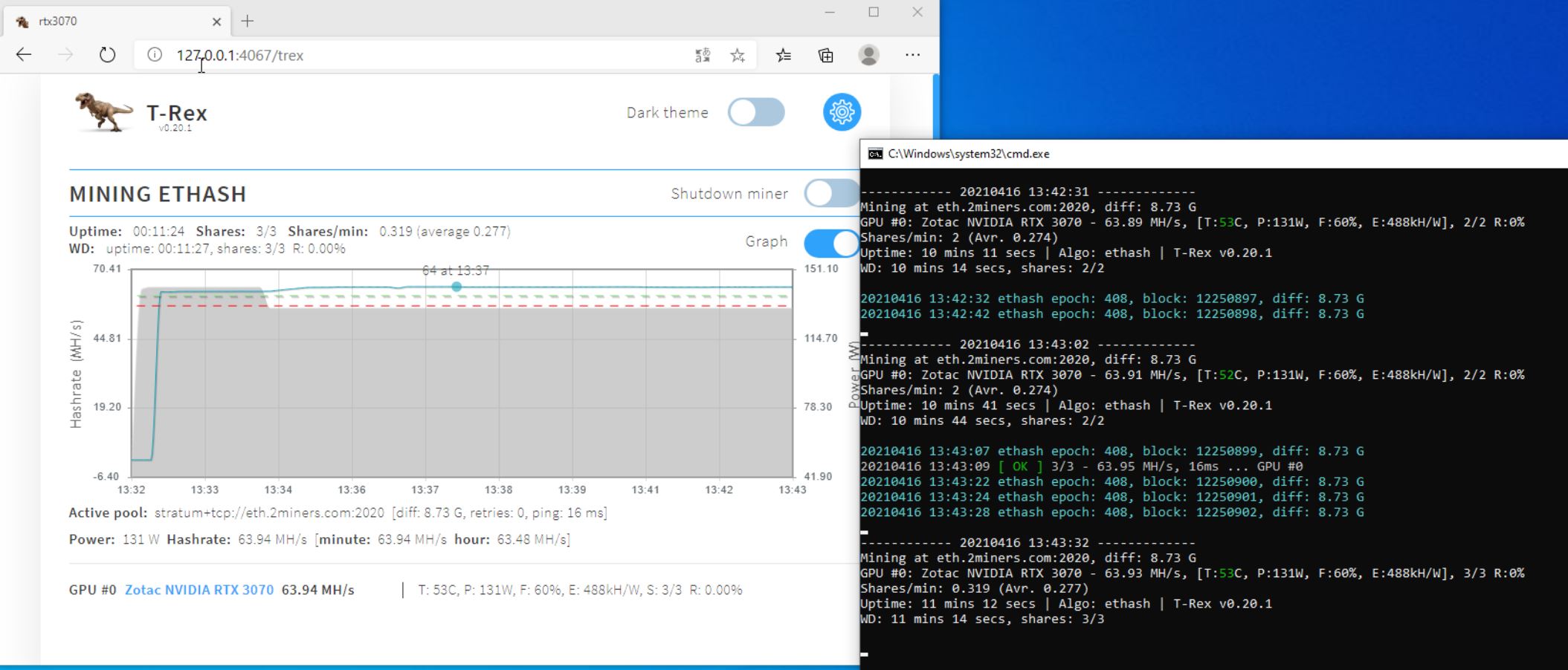

i created a windows 10 VM. was a bit difficult to get that running well with 6.9.2 - always crashed the whole unraid server during nvidia driver installation. setup.exe -s was succesful, a silent driver installation.
then with afterburner settings applied i was able to mine with nearly 64 MH/s which is quite fast for a RTX3070 🙂
Might work fine with one GPU, i didn't get any luck by trying to pass through more than one to a VM. Dunno why, but docker worked for me 😛
Been able to get 60mh with 3070 just on 130watt through Windows. Any idea why the container needs extra 20w to get the same hashrate?
I have no idea, different drivers perhaps (windows and Linux drivers might behave differently for all i know). I haven't tried it myself, but ensure that the gpu and memory clock is exactly the same (the input is different from windows and Linux drivers)
And also, do you use the same tool to check the actual power usage, nvidia-smi? Some 3rd party tools might show different numbers, I dunno.. just a thought.
Interesting. I have not checked the power usage with the same tool. I've checked with nvidia-smi with unraid and I've only tested nicehash's own miner's (when the card was plugged into a windows machine) reporting which was kind of nice. It gives wattage and efficiency rating based on wattage vs hashrate. Anyway now I mine ETH directly with a pool. 20w ain't nothing but it's also not big enough difference in power bill for me to worry about it too much. I'll fiddle with OC settings a bit more.
PS. which specific 3070 model did you write those settings? I am running FE model.
I have a RTX 3070 Gigabyte Gaming OC 8GB, but it sits inside a relatively hot server, so I expect some hashes might be lost just there.
But it's important to compare with the same tools, maybe nicehash calculates hasrates differently as well. A fair comparison would be using nsfminer for windows and the one in linux/docker container, and then use nvidia-smi on both windows and linux to determine power usage (maybe also nvidia-smi shows the same clocks as well across platforms?).
Just an update. Been playing around with the settings a bit over the weekend and I managed to get the 3070 FE to 60.45MH with lower power usage.
Settings
pl: 135
clock offset: -503
memory offset: 2300
fan: 70
130w can get to 60 but was struggling to keep it locked at 60. Would dip to 59 here and there. So I just gave it 5 more watts. More efficient than 150 I was using before.
Settings
pl: 135
clock offset: -503
memory offset: 2300
fan: 70
Nice, decided to fiddle around with your numbers.. and should have done a bit more fiddling earlier.. ended up with these results on the RTX 3070:
  • Power limit: 120W (seems to be the minimum allowed for my card)
  • Clock offset: -550
  • Memory offset: 2300
  • Fan: auto
Hashrate: 60.2 MH/s - so apparently very effective!
Edited by olehj
