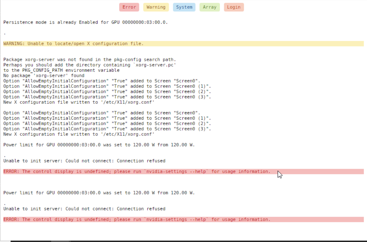

When I try to install it, I get

I am having a different issue now though. Have you seen this before?
Yes, it might be that you run different nvidia driver versions, check that you DON'T run the "latest" nvidia driver, but set it static to 460.67.
Correct, that is how it’s setup. I did upgrade to 460.67 and I have restarted the system to apply the new driver
By chance that any other docker container with privileged rights or VM's uses this GPU? The results might vary. I am running a Quadro P2000 fine myself in both Emby and nsfminerOC. I'm not sure what might block this, the mileage might vary from card to card and system to system.
I had plex using it as well as the os was booted into GUI mode. I have booted the os into standard mode and removed it from plex as well. No VMs.
The GUI mode is likely the problem, should run fine with Plex (I use mine with Emby without problem, and it's sort of the same thing).
I’ve already booted into non-GUI mode and the issue continues. I also removed the plug-in GPUstat in case that was causing it, but it continues as well.
GPU stat, Emby/(probably Plex) should cause no issue with this docker container. Open regular Unraid terminal and verify that your GPU is set at the correct GPU ID. And check if you maybe see some hints in the Syslog? Sorry, I don't have any other ideas at the moment.

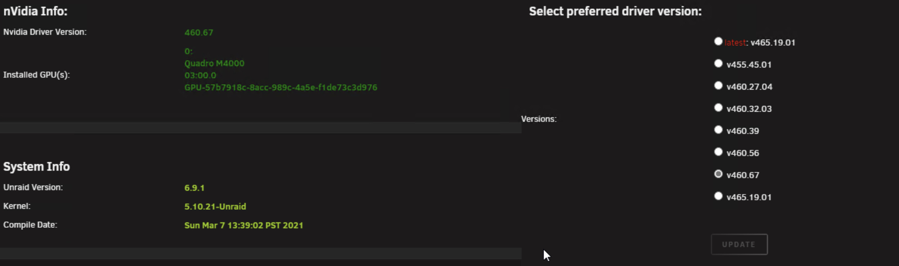

What format should the GPU ID be?

0, 1, 2 etc.
Of this screenshot, what should I put in the GPU variable?
0
