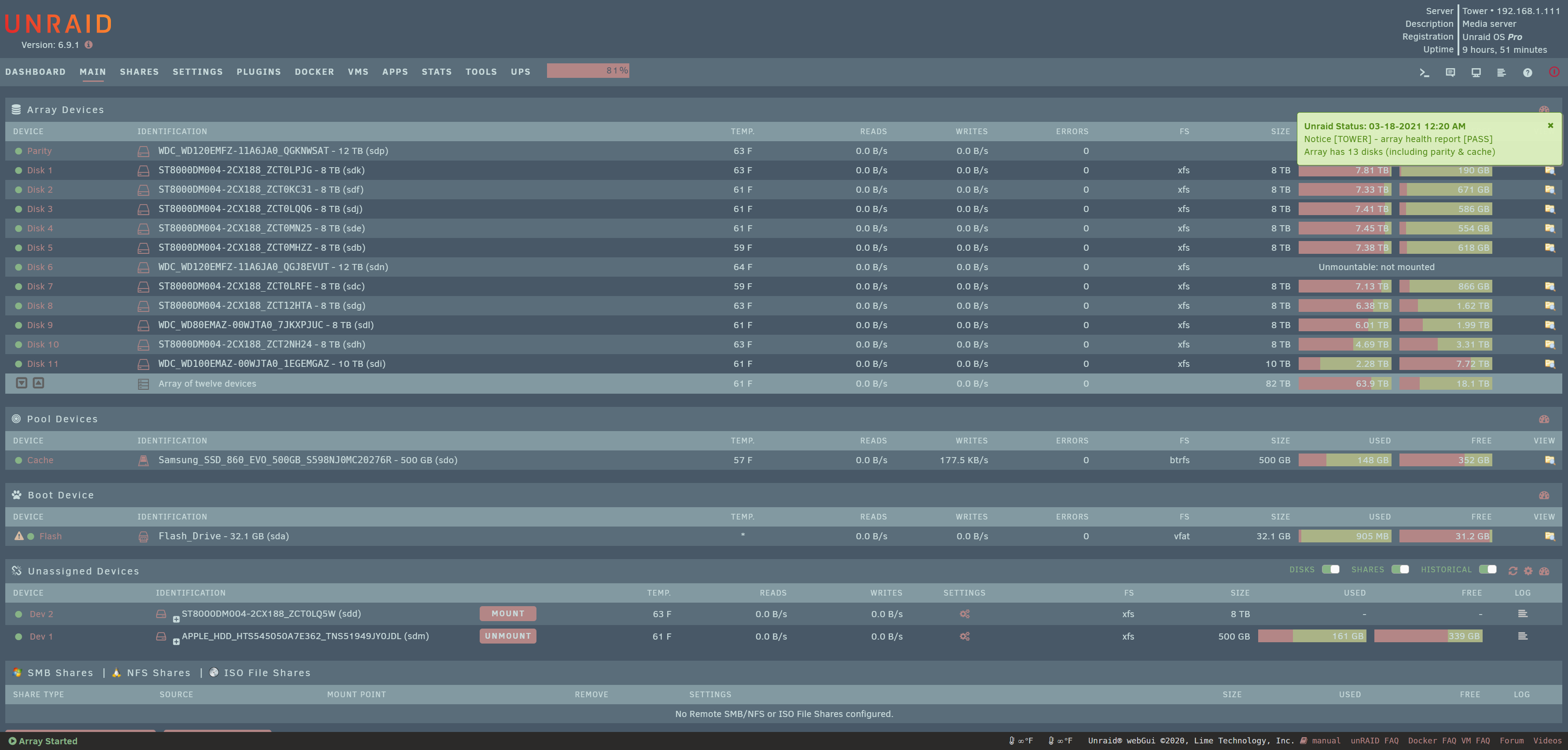

Hello,
Been using UnRAID for a few years now, had a few bumps along the way and using the forums usually been able to help myself.
I have read through a couple of other posts with similar/same problems, but they are a couple years old and I want to make sure I proceed correctly.
A month or so ago I replaced my parity drive with a larger one, had a 10TB and replaced with a 12TB, since those are getting better price wise. I have mosttly 8TB drives and now the one 12TB and precleared the 10TB and using it as a data drive now. I also bought a second 12TB and precleared it as well to have as a spare.
A few days ago I was getting a lot of read errors and drive 6 dropped out. Drive 5 also had some read errors, but UnRAID did not kick it out. I know this can be a bad/lose power or data cable, so I stopped the array and shut down the system. I went through and reseated all the drive connections and powered the system back up and drive 6 was still marked as not useable. So I thought to be safe I would put the precleared 12TB spare drive in the system and replace drive 6 with it, then later I would preclear the original drive 6 and see if it really had problems. I shutdown the system and installed the 12TB spare, powered up, and selected the new drive for slot 6. I started the array and the rebuild took place. It stopped a couple time from the parity check pause plugin but it resumed and finished. I thought it was OK, but drive six showed as after the parity completed. It may have listed it that way during the rebuild, but I am not sure at this point. I still have the original drive 6 in the system, and it shows up right now as 'Dev 2' in unassigned devices as shown in the screen shot.
I have attached a diagnostic and screen shot. I'd like some advice as how to proceed, as I am not sure the REAL state of the array.
Thank you for your time and help.
Matt
tower-diagnostics-20210317-2210.zip
