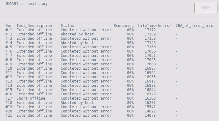

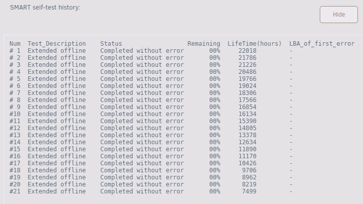

How about the test history showing, pls show it as above pictures for individual disk.
Edited by Vr2Io
