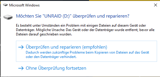

The first message in windows told me there is something wrong, if i want to check and repair it.
Possible cause: "The device was ejected before all files were written."
But i skipped this and made a chkdsk (see below)
But chkdsk /r found no errors:
