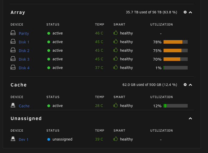

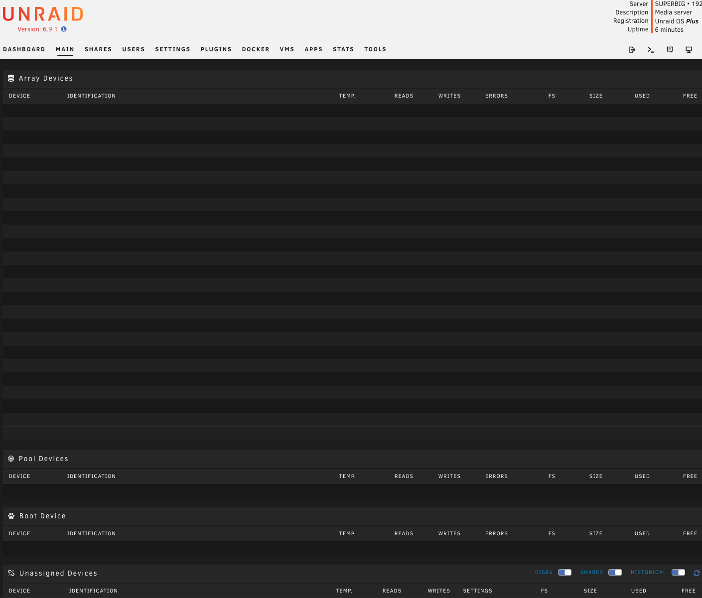

since a few minutes ago main tab does not show any devices, but everything seems to be ok. Dashboard shows the disks, docker images are running. Any help will be appreciated.
Thanks in advance.
PS: I restarted the system, but continues failing.
Edited by xabi

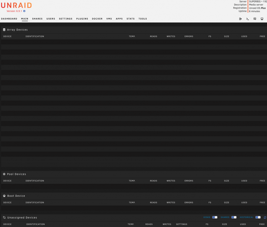

Added another screenshot

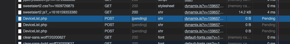

More info from the network tab of the browser:
These request are pending

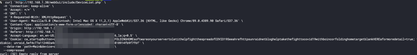

Making the request from the Command Line:
That's over my head.
