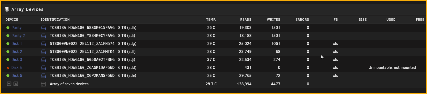

Logged into my UnRAID server to day after noticing some lag in my Plex/Emby streaming, and saw one of my 6TB drives is disabled.
Running a check with the -n switch from the GUI gives this data, and then MILES of additional line. The drive comes back good on SMART checks, but I don't know the "proper" way to resolve this.

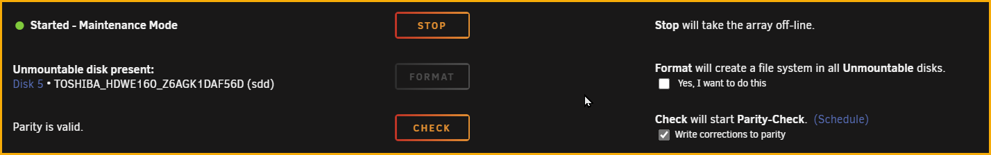

Should I :
1. Check the checkbox to format all unmountable disks
2. Pull the drive and just replace with a new drive
My parity is still good, so I don't think I lost anything.  Is that true?  Is there any way to pull the data from parity and place on the good disks without reusing the existing "bad" drive? UnBalance doesn't see the disk to move data, console also don't have the disk available for a file copy, and I'm hoping parity will just do its job when required.
I have a new 8TB WD Red coming but that won't be here till Monday.  NO ONE around here sells drives but Micro Center, so I may take a trip down there and bring some Vaseline for the checkout process.
Any help would be greatly appreciated.
Phase 1 - find and verify superblock...
Phase 2 - using internal log
        - zero log...
        - scan filesystem freespace and inode maps...
bad magic number
Metadata CRC error detected at 0x439496, xfs_agf block 0x1ffffffe1/0x200
agf has bad CRC for ag 4
Metadata CRC error detected at 0x4643f6, xfs_agi block 0x1ffffffe2/0x200
agi has bad CRC for ag 4
bad on-disk superblock 4 - bad magic number
primary/secondary superblock 4 conflict - AG superblock geometry info conflicts with filesystem geometry
would zero unused portion of secondary superblock (AG #4)
bad magic # 0x846ee5fe for agf 4
bad version # 1217142957 for agf 4
bad sequence # 275752827 for agf 4
bad length 846806836 for agf 4, should be 268435455
flfirst 825879604 in agf 4 too large (max = 118)
fllast -625122927 in agf 4 too large (max = 118)
bad uuid 640e9a0b-cc46-db6d-4980-7e8450ebb7bd for agf 4
bad magic # 0x2ceeb90b for agi 4
bad version # 1606560011 for agi 4
bad sequence # 716564984 for agi 4
bad length # 23987019 for agi 4, should be 268435455
bad uuid 228d1fd7-ad8d-60fe-c469-6df73ae042eb for agi 4
would reset bad sb for ag 4
would reset bad agf for ag 4
would reset bad agi for ag 4
bad uncorrected agheader 4, skipping ag...
sb_icount 36160, counted 30272
sb_ifree 1268, counted 1029
sb_fdblocks 653835694, counted 536472444
        - found root inode chunk
Phase 3 - for each AG...
        - scan (but don't clear) agi unlinked lists...
        - process known inodes and perform inode discovery...
        - agno = 0
        - agno = 1
        - agno = 2
        - agno = 3
        - agno = 4
        - agno = 5
        - process newly discovered inodes...
Phase 4 - check for duplicate blocks...
        - setting up duplicate extent list...
        - check for inodes claiming duplicate blocks...
        - agno = 0
        - agno = 2
        - agno = 1
        - agno = 4
        - agno = 5
entry "Al-Qadim - The Genie's Curse (January 1, 1994)" at block 0 offset 96 in directory inode 4294967424 references non-existent inode 8589934720
	would clear inode number in entry at offset 96...
entry "Death_Knights_of_Krynn_GOG_Linux_-_`Death_Knights_of_Krynn_(January_1__1990).nzb`_yEnc_(00_23)" at block 0 offset 568 in directory inode 4294967424 references non-existent inode 8589934721
	would clear inode number in entry at offset 568...
entry "Gateway_to_the_Savage_Frontier_GOG_Linux_-_`Gateway_to_the_Savage_Frontier_(December_1__1988).nzb`_yEnc_(00_26)" at block 0 offset 1304 in directory inode 4294967424 references non-existent inode 8589934722
	would clear inode number in entry at offset 1304...
entry "Ravenloft_-_Stradh's_Possession_GOG_Linux_-_`Ravenloft_-_Strahd's_Possession_(January_1__1994).nzb`_yEnc_(00_31)" at block 0 offset 1920 in directory inode 4294967424 references non-existent inode 8589934723
	would clear inode number in entry at offset 1920...
        - agno = 3
entry "Videos" in shortform directory 128 references non-existent inode 8876442261
would have junked entry "Videos" in directory inode 128
would have corrected i8 count in directory 128 from 7 to 6
entry ".." at block 0 offset 80 in directory inode 10737418430 references non-existent inode 8645206841
entry "config" in shortform directory 1126273 references non-existent inode 8589934778
would have junked entry "config" in directory inode 1126273
entry "syslinux" in shortform directory 1126273 references non-existent inode 8590602900
would have junked entry "syslinux" in directory inode 1126273
would have corrected i8 count in directory 1126273 from 5 to 3
entry "IMG_20200124_0001~20200208-075113.pdf" at block 0 offset 136 in directory inode 1126275 references non-existent inode 8723369622
	would clear inode number in entry at offset 136...
would have reset inode 6556482029 nlinks from 4 to 3
would have reset inode 6556482040 nlinks from 3 to 2
would have reset inode 6556482041 nlinks from 4 to 3
would have reset inode 6556482178 nlinks from 6 to 5
would have reset inode 6556482179 nlinks from 7 to 6
would have reset inode 6556482215 nlinks from 11 to 9
would have reset inode 6556483103 nlinks from 3 to 2
would have reset inode 6556483132 nlinks from 6 to 5
would have reset inode 6556483133 nlinks from 3 to 2
would have reset inode 6556483134 nlinks from 3 to 2
would have reset inode 6556483135 nlinks from 4 to 3
would have reset inode 6573662018 nlinks from 13 to 11
would have reset inode 6573679000 nlinks from 5 to 4
would have reset inode 6573679002 nlinks from 4 to 3
would have reset inode 6573679003 nlinks from 3 to 2

6 hours ago, KryptykHermit said:
Should I :
Neither, format is never an option to recover data and parity can't help with filesystem corruption.
Run xfs_repair without -n to see if all the data comes back and there aren't a lot of lost+found files in the emulated disk, if it's not a good result you can mount the actual disk outside the array and check that.
