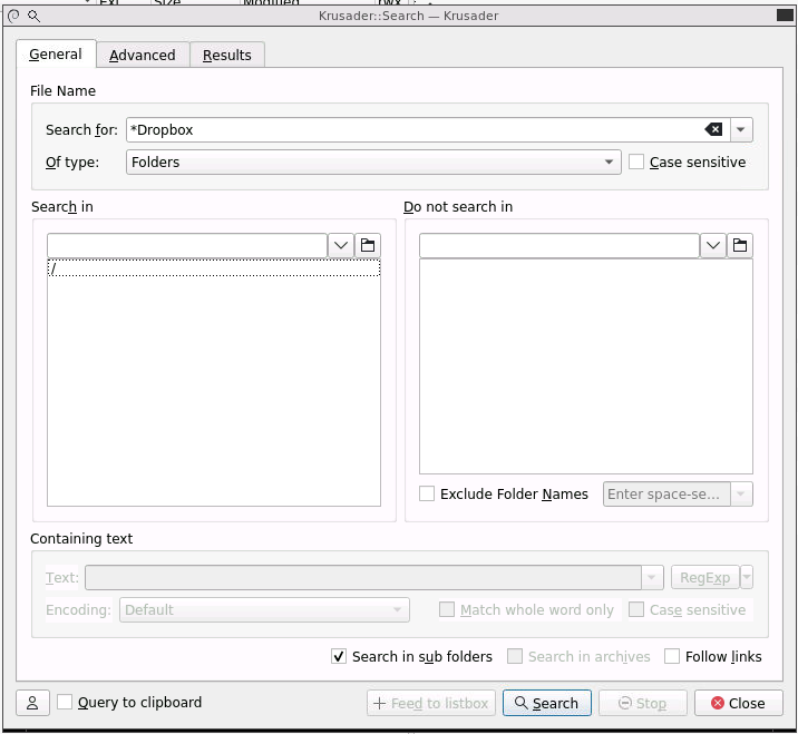

Hi Purkan,
What I would do is use Krusader to search for folders of those names on your system. You can find 'Search' in the 'tool' menu, or just hit the magnifying icon if shown.
Then, I would check out the directory matches found.
Hope this helps!
Ed

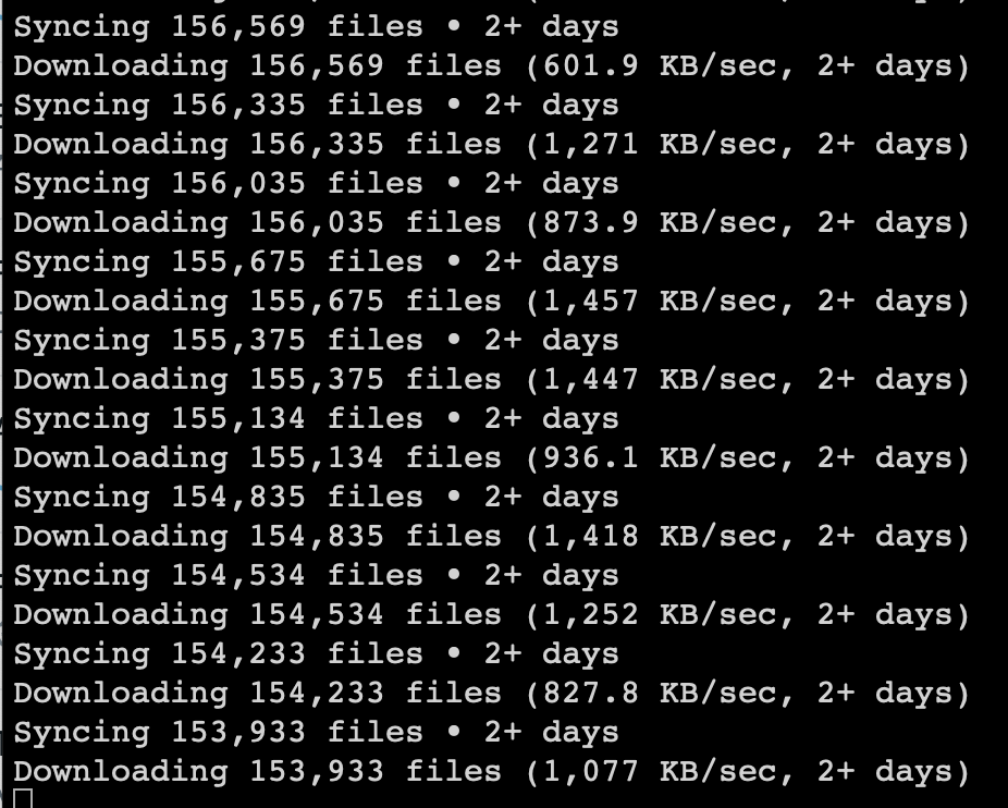

my dropbox docker works ok in the sense that is sync files, but it keeps on crashing. I installed it last week and it does syncs, but not completely and then crash. When it finaly sync completely it works and I see a lot of "up to date" or something like that, but then eventually it crash again.
Has this been solved or is there a way around this? What info should I provide here to get help, or where should I look to find clues of what is going on?
here are some logs from the docker.
logUnraidDropBox2023-07-31.txt logUnraidDropBox2023-07-28.txt logUnraidDropBox2023-08-02.txt
I’ve given up on this app, kept disconnecting…went the rclone way, and it works flawlessly…

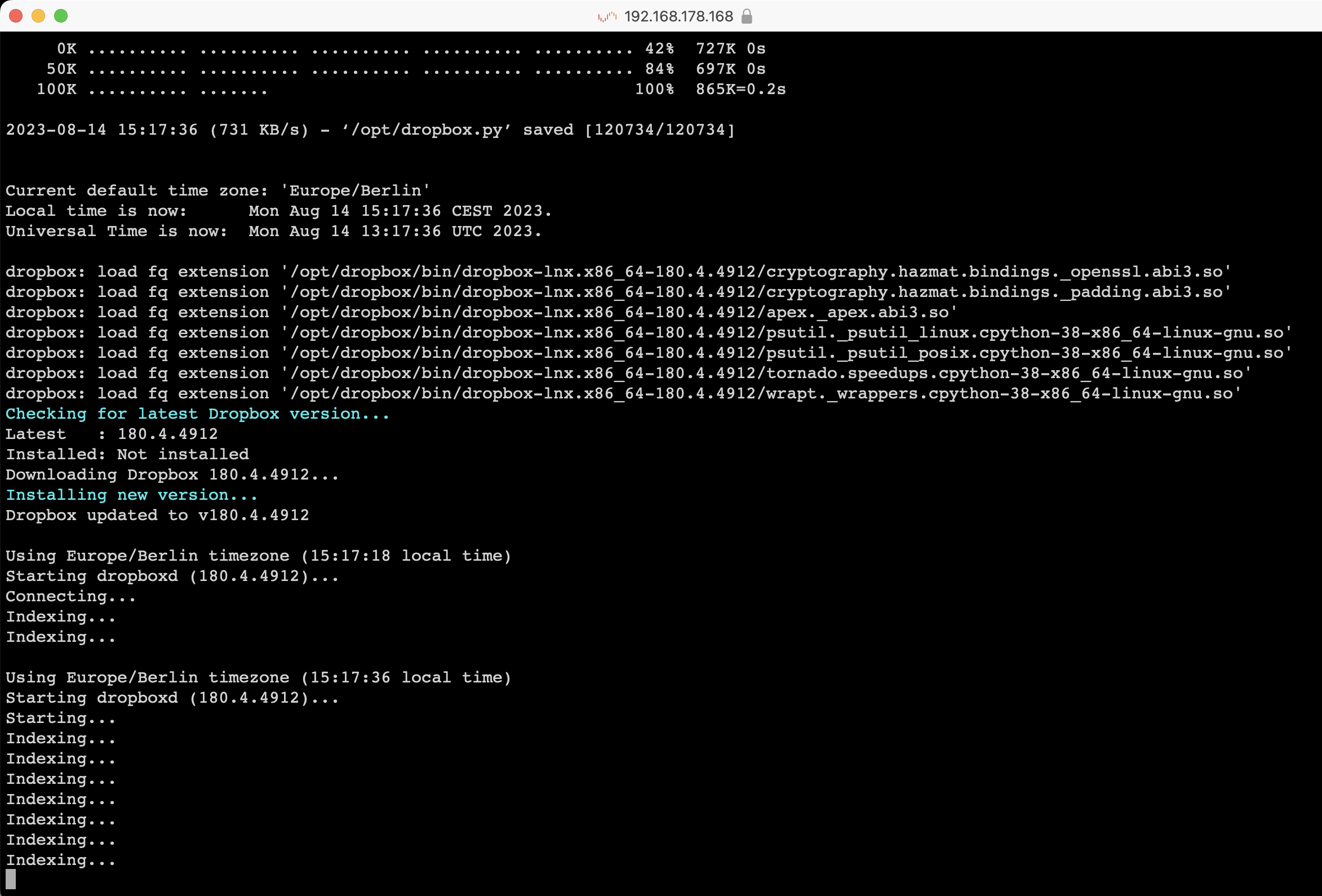

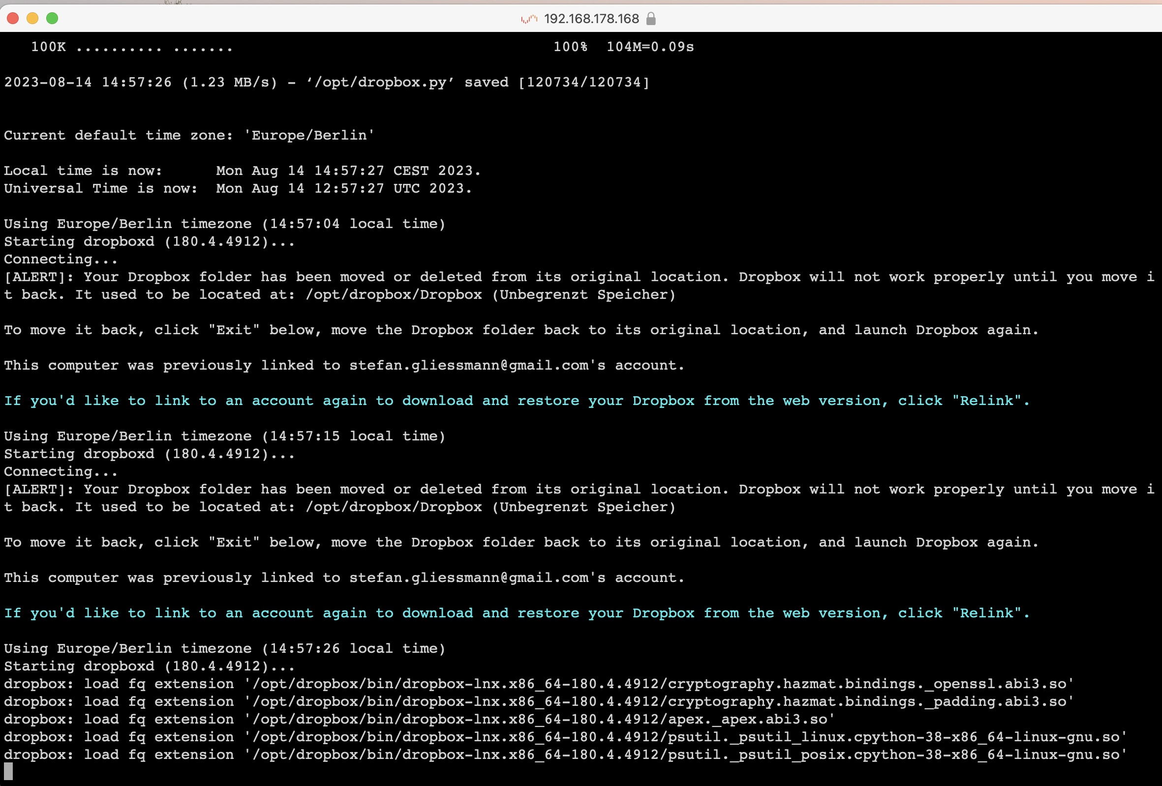

Hey there!
I followed the instructions outlined by gr8zatara ...
however, restarting the container after successfully authorization to my dropbox, update starts and gets finished, but then I get:
ALERT: Your Dropbox folder has been moved or deleted from its original location. Dropbox will not work properly until you move it back. It used to be located at: ....
What did I do wrong?
Solved it ... I hope ...
I modified the Container Path: to what it wants according to the log and now it is indexing ... and indexing ... and indexing ...

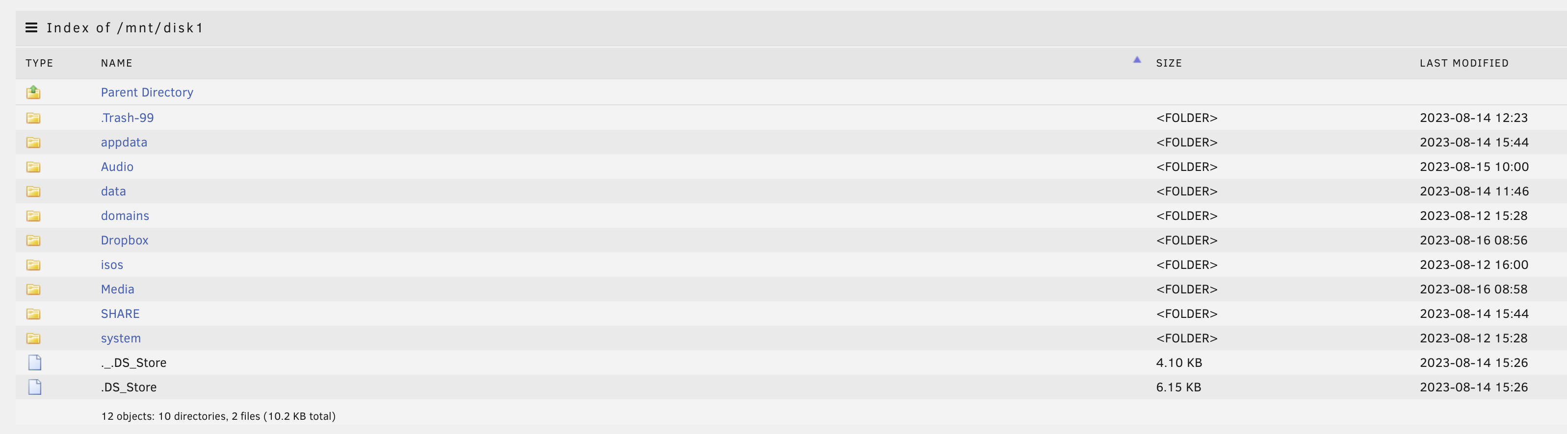

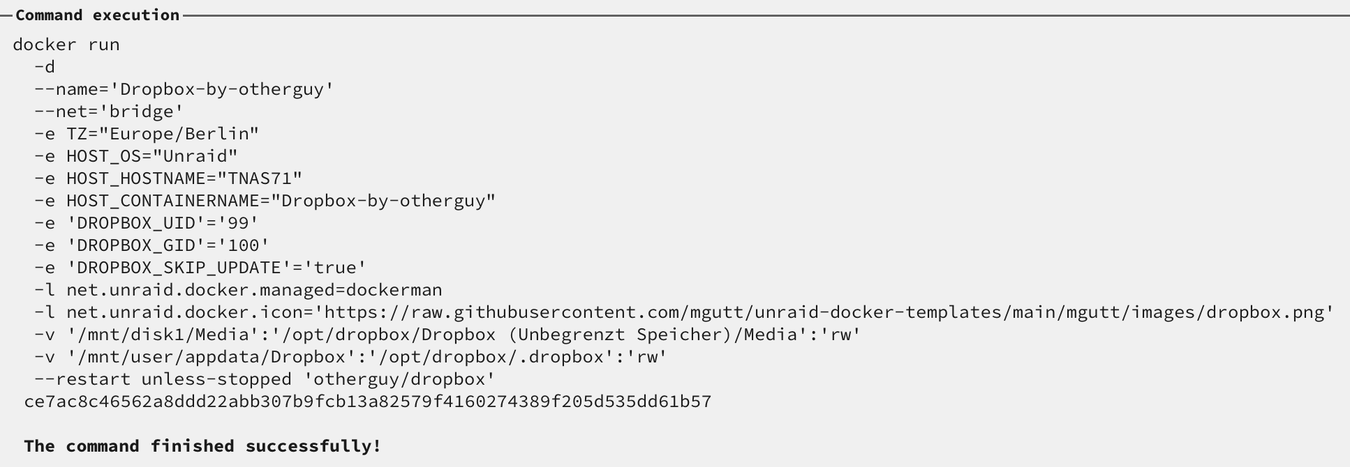

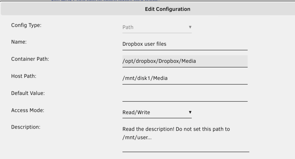

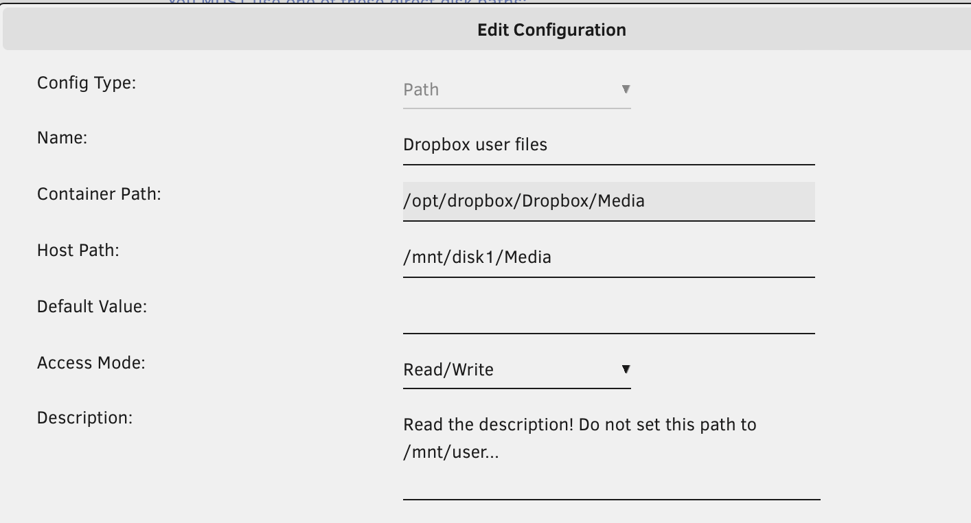

As I want to sync only one folder out of my Dropbox to Unraid and vice versa, I did the following:
- I modified the Container Path to reflect the one folder I want to sync
- specified the Host Path to be /mnt/disk1/Media
- v ' /mnt/disk1/Media':' /opt/dropbox/Dropbox (Unbegrenzt Speicher) /Media': 'rw' during docker run seems to do what I want 😇
- when I look up Media under Shares, I can see it as /mnt/user/Media and under Main as /mnt/disk1/Media - is this normal?
currently, it is indexing as the folder Media in Dropbox is roughly 24 TB ...

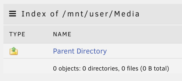

Update: it is now syncing & downloading. However, I do not find any files or directories in /mnt/disk1/Media nor /mnt/user/Media ...
Any feedback would be appreciated! 🙏

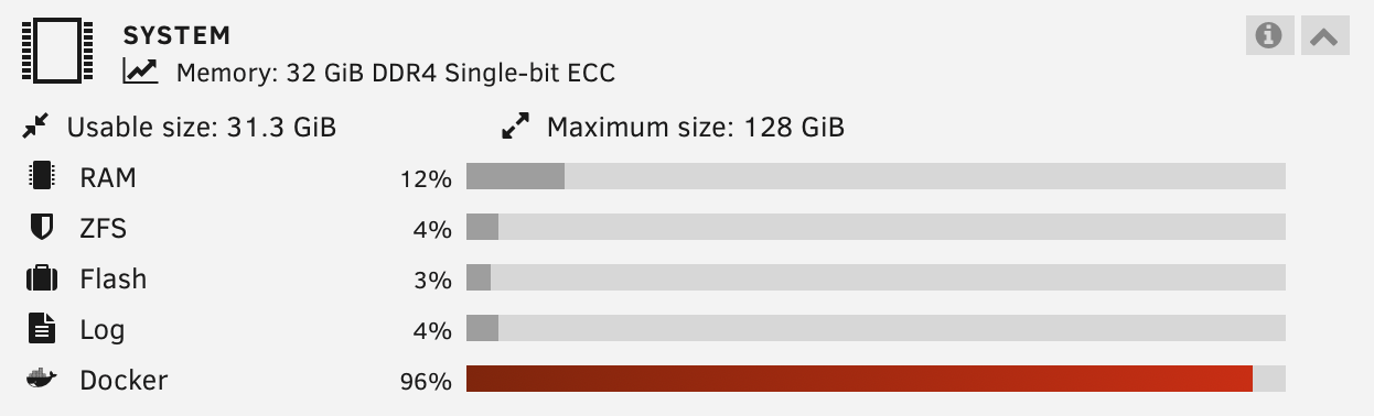

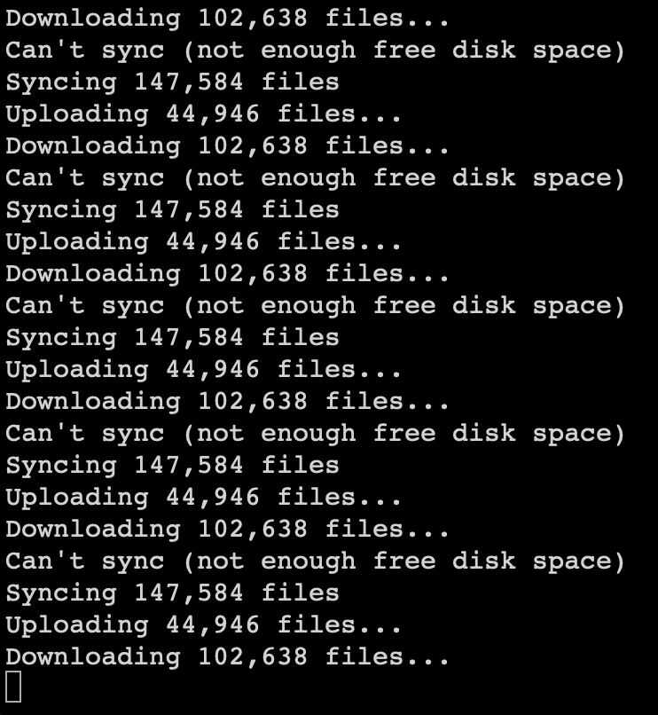

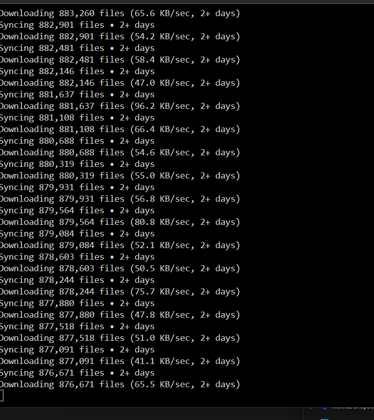

Hmm - after synching for a while, it has now stopped as it would not have enough free disk space ...
My array is plenty big approx 80 TB and the time would not have been enough to transfer this amount of data to my local Unraid ...
So looking further, it appears that the memory for Docker has reached 96% ...
And I have no clue on how to change that ... (especially, as the docker was running fine the previous data transferring 0.5 TB).

What I would do is make a dropbox that only has a few files so it doesn't take so long to see what goes wrong.  Can you please send a pic of your docker container config screen?
Hi @gr8zatara,
in the meantime, I removed it and started with a fresh UnRaid install.
I was able to setup Rclone Browser and it is synching just fine now.
I believe my mistake was not reading the original instructions carefully enough.
It says that "If you are using BTRFS, change your docker installation to a folder."
Well - my docker installation is in NVME_DOCKER which is *not* a directory in the array ...
On 8/10/2023 at 8:19 PM, gr8zatara said:
Finally, in advance view toggle near top, add '--restart unless-stopped'
That solved my problem! Thanks a lot!

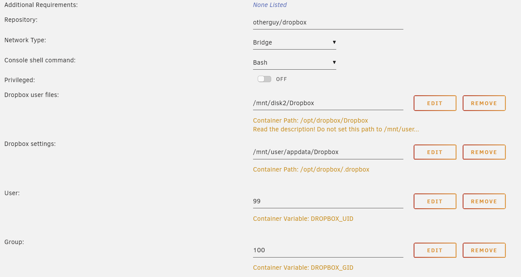

Hello,
I followed the installation steps, but after successfully linking the new device by clicking the link, nothing happens after the "Welcome Alain." prompt. When I restart the container, it seems as if the device is no longer linked and I am prompted to link the device again:
Checking for latest Dropbox version...
Latest   : 192.4.4605
Installed: 192.4.4605
Dropbox is up-to-date
Using Europe/Paris timezone (09:43:33 local time)
Starting dropboxd (192.4.4605)...
dropbox: load fq extension '/opt/dropbox/bin/dropbox-lnx.x86_64-192.4.4605/cryptography.hazmat.bindings._openssl.abi3.so'
dropbox: load fq extension '/opt/dropbox/bin/dropbox-lnx.x86_64-192.4.4605/cryptography.hazmat.bindings._padding.abi3.so'
dropbox: load fq extension '/opt/dropbox/bin/dropbox-lnx.x86_64-192.4.4605/apex._apex.abi3.so'
dropbox: load fq extension '/opt/dropbox/bin/dropbox-lnx.x86_64-192.4.4605/psutil._psutil_linux.cpython-38-x86_64-linux-gnu.so'
dropbox: load fq extension '/opt/dropbox/bin/dropbox-lnx.x86_64-192.4.4605/psutil._psutil_posix.cpython-38-x86_64-linux-gnu.so'
dropbox: load fq extension '/opt/dropbox/bin/dropbox-lnx.x86_64-192.4.4605/tornado.speedups.cpython-38-x86_64-linux-gnu.so'
dropbox: load fq extension '/opt/dropbox/bin/dropbox-lnx.x86_64-192.4.4605/wrapt._wrappers.cpython-38-x86_64-linux-gnu.so'
This computer isn't linked to any Dropbox account...
Please visit https://www.dropbox.com/cli_link_nonce?nonce=XXXXXXXXXXXXXXXXXXXXXXXXXX to link this device.
When I click the link and add the device, I get this:
Please visit https://www.dropbox.com/cli_link_nonce?nonce=XXXXXXXXXXXXXXXXXXXXXXXXX to link this device.
This computer is now linked to Dropbox. Welcome Alain
And then it just sits there.
My settings for the container are as follows:
Edited by AlainF

I reinstalled the docker container and tried the "new" mapping from the get-go. This is when I saw the following in the log:
Using America/New_York timezone (15:43:25 local time)
Starting dropboxd (194.4.6267)...
[ALERT]: Your Dropbox folder has been moved or deleted from its original location. Dropbox will not work properly until you move it back. It used to be located at: /opt/dropbox/****** Dropbox
To move it back, click "Exit" below, move the Dropbox folder back to its original location, and launch Dropbox again.
This computer was previously linked to k******@********.com's account.
If you'd like to link to an account again to download and restore your Dropbox from the web version, click "Relink".
** Press ANY KEY to close this window **
I realized when I was mapping the paths, the default mapping was:
Container Path: "/opt/dropbox/Dropbox"
My main dropbox folder actually has the company name in front so its "******* Dropbox"
Solutions:
  • Initial problem - docker.img growing like crazy and not seeing any files in the designated dropbox folder - I changed the Container Path: "/opt/dropbox/Dropbox" to host: "/opt/dropbox/" that way anything that is being sent to the "dropbox" folder within the container image will funnel to the designated host path
  • I still had to solve the current bloat problem which would not go away, even after I had deleted the container and "removed" the image. Of course, @SpaceInvaderOne came to the rescue:
    • this youtube video: https://www.youtube.com/watch?v=9DxPEfbAJJ0
    • *note* when I ran the script, there was nothing in the results that showed this mysterious 29GB outside of the fact that in the total used space, it was showing 49GB. I nonetheless followed the instructions and edited the following two lines:
      • remove_orphaned_images="yes"  # select "yes" or "no" to remove any orphaned images
        remove_unconnected_volumes="yes" # select "yes" or "no" to remove any unconnected volumes
    • Once I did that and re-ran the script, the mysterious 29GB disappeared
  • Reinstalled and remapped the container (as outlined in step one above). I got the wonderful alert seen above yet again. I went to dropbox.com --> account settings --> security --> unlinked --> restarted the container --> relinked --> everything seems to be working as originally expected
-K
