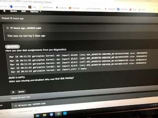

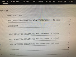

When you assign the disks, refer to the assignments I already posted above. The serial numbers are clearly listed in those posts, and those same serial numbers will appear in the drop down selections for each disk. Just match them up and you should be good.
If you assigned a disk4 in the past, but then removed it, then your server has been waiting for you to replace it all that time, and so you had no parity protection since you already had a missing disk.
What about that SSD I mentioned?
Mar 18 20:11:52 garysplex emhttpd: KINGSTON_SV300S37A120G_50026B7757073B82 (sdd) 512 234441648
Post new diagnostics after assigning the disks but before starting the array if you want me to check.

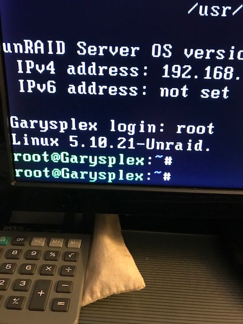

I just booted up and it stopped at garysplex log in
What do i have to enter to go further?
The username is root and the password is blank since you didn't keep any of your configuration.
This is were it stops at log in after i enter root and hit enter
Can't you access the WebGUI? By name or IP?
before it would come up by itself.
Then you were probably booting in GUI mode, you can do that but can also still access the webGUI over the network using a PC or even phone.

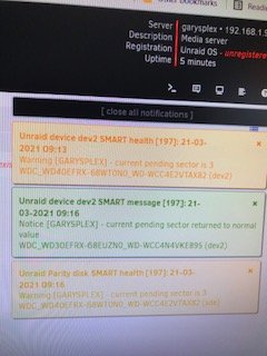

Now I have notifications after I set up the old disk order. Am i getting this notification because there are files on all these discs that i dont want to lose? Is it ok to start array?
Edited by vid1953
Those notifications are for disk SMART problems. Each disk itself keeps track of certain things in its firmware that relate to how the disk is working. Pending sectors are an important problem to watch out for on disks, which is why Unraid notifies you about them.
Post new diagnostics.

On WD RED disks, you should also have Unraid monitor SMART attributes 1 and 200. Click on each disk to get to its page and under SMART attribute notifications you can add 1,200 to the Custom attributes.
I recommend setting up Notifications to alert you immediately by email or other agent as soon as a problem is detected.

You should start the array now even without parity just to confirm your data is still there.
Just shut down and remove the old parity and then start up again and start the array or just unassign it?
12 minutes ago, vid1953 said:
just unassign it?
This is all that is needed

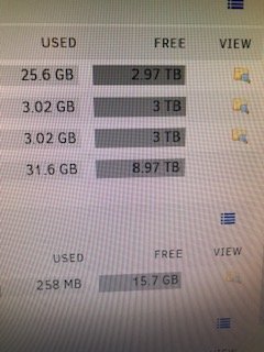

Unless I am looking at it wrong, the 3 discs are started after unasigning the parity disc.
I had over half of my discs filled and now i only show 31 GB used. If this is true I just lost 600 movie files.
Looks like it, you are hacked, like a few users were in the last week, make sure no ports are open to your server, or it's in the dmz.
