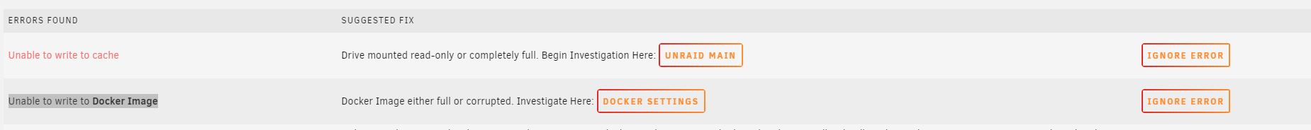

I'm not sure if this is helpful, but i just noticed that the "Fix Common Problems" app now has errors that state:
  • Unable to write to cache
  • Unable to write to Docker Image
I pulled another diagnostics incase it's helpful.
