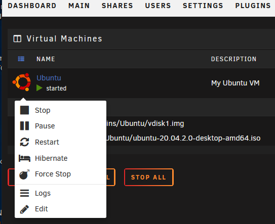

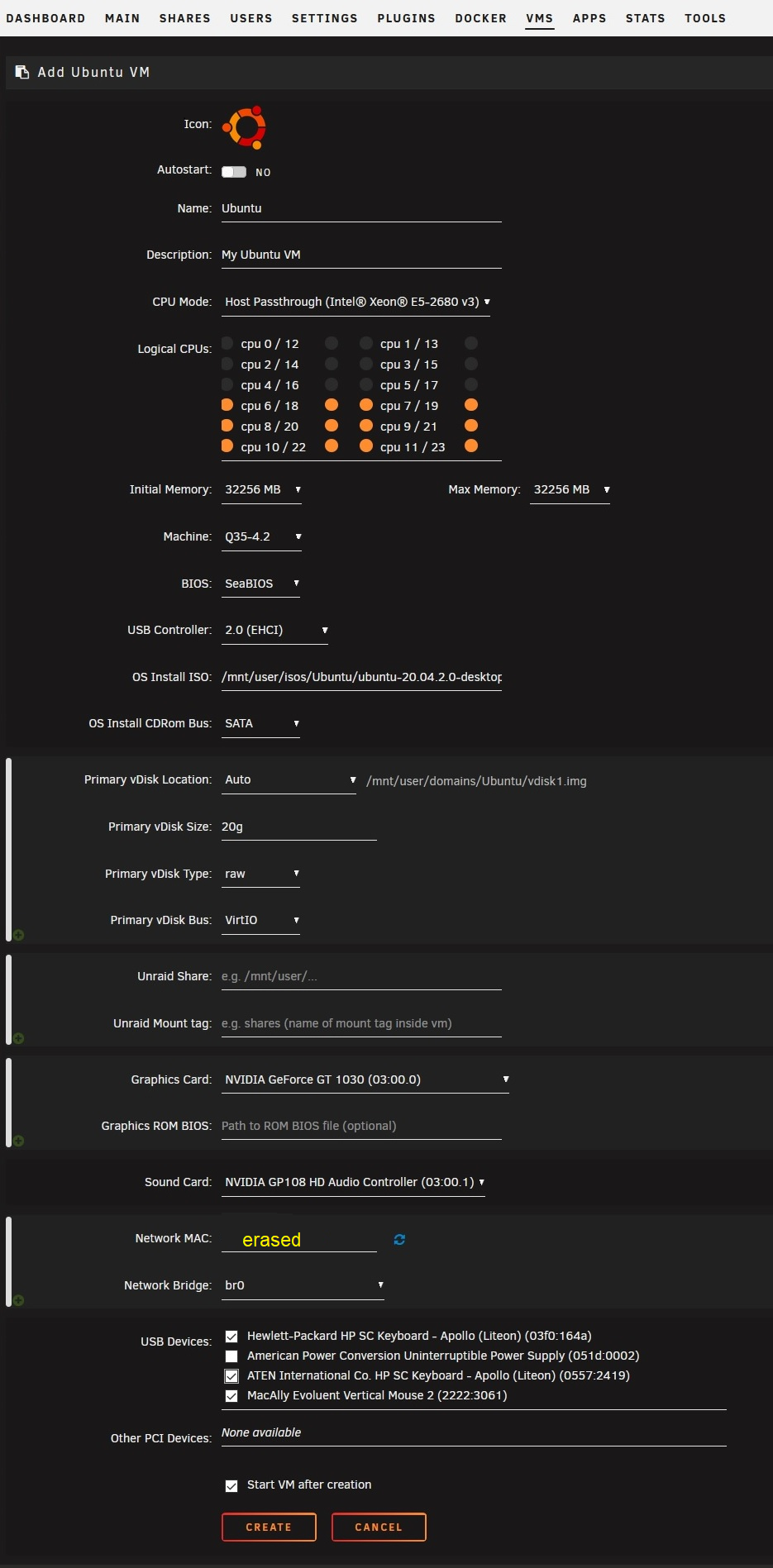

I am attempting to setup an Ubuntu VM with no success. After I hit the CREATE button my Ubuntu OS installation process does not appear within a browser window.  Also when I click on the Ubuntu icon what I see missing is the Remote View command as shown in screen capture below. The second screen capture below shows all of the settings I used for my Ubuntu setup.
Can anybody in the community please help me in identifying what could possibly be the problem that is preventing my Ubuntu OS installation process from launching.  Thank you for your time.

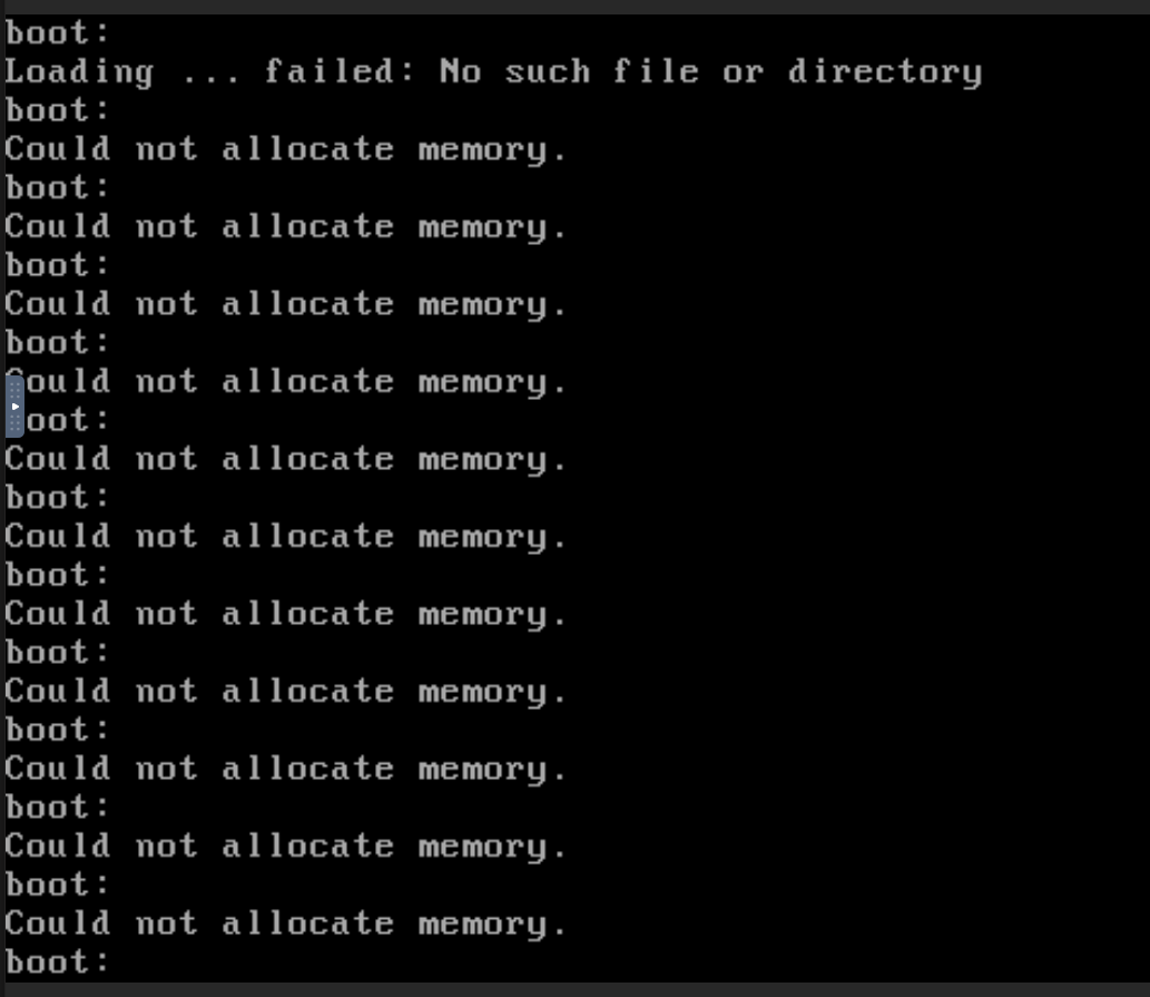

I changed my Graphic Card parameter from Nvidia to VNC and now I successfully get a "VNC Remote" command.  However below is what I now see in the VNC Remote screen.    Does anybody in the community have any advice as to how the problem below can be fixed?
These are the settings I use for Ubuntu Desktop. Try OVMF rather than see BIOS
Thank you SimonF.  I changed it to what you suggested and it works. The reason I used SeaBios is because SpaceInvaderOne in his YouTube video says to change it to SeaBios.
