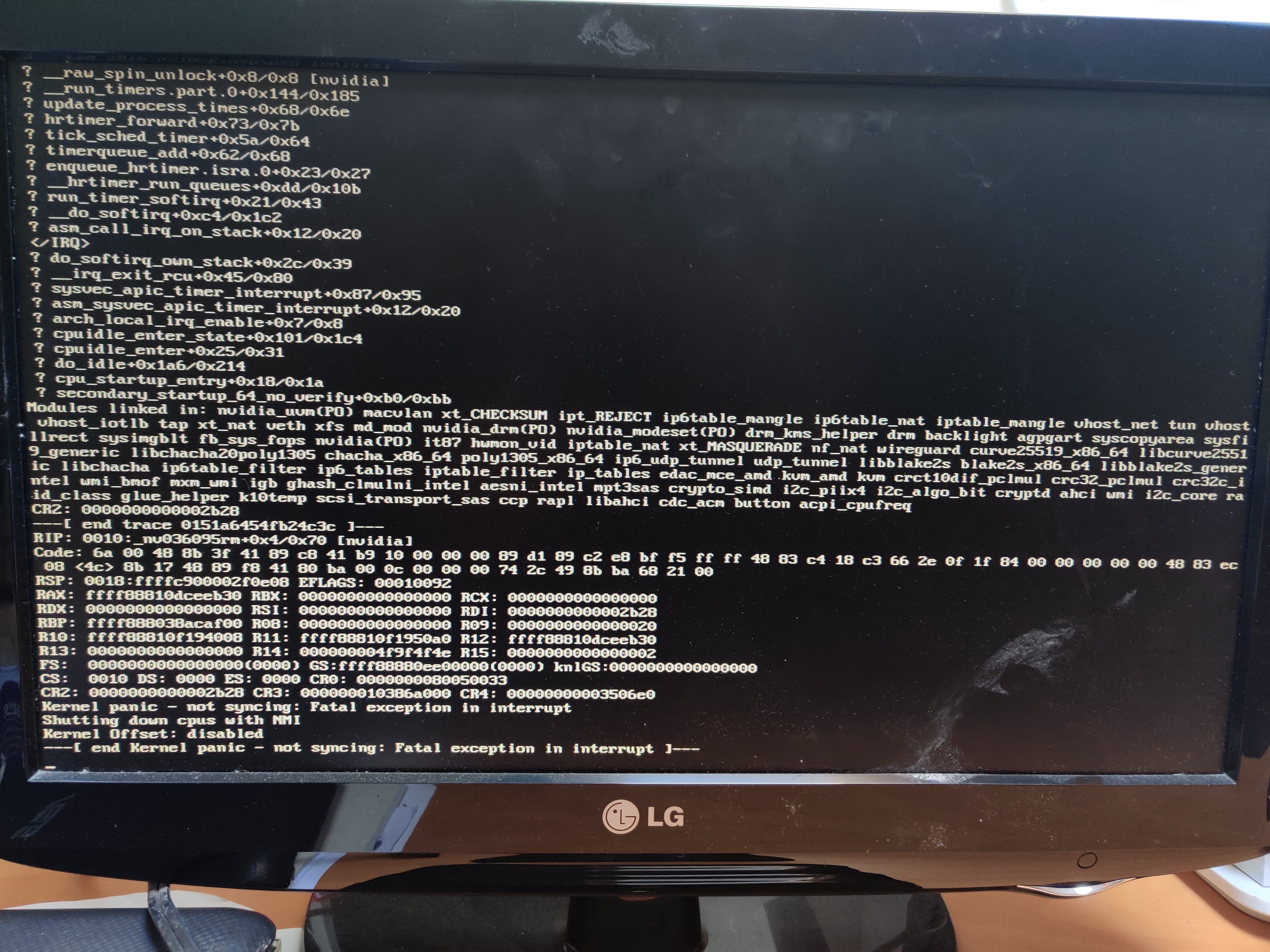

As title said, after update to 6.9 stable and 6.9.1 stable, server random lock up.IMG_20210320_172133.thumb.jpg.b1eef9d7ad2b5e4c6d41ddcc88cc0270.jpg
On screen i have this...
Never had this, in 2 years.

Unfortunately there's nothing logged about the crash, one thing you can try it to boot the server in safe mode with all docker/VMs disable, let it run as a basic NAS for a few days, if it still crashes it's likely a hardware problem, if it doesn't start turning on the other services one by one.

I was having the same issue. I had 3 crashes and then I went back to unRAID 6.9.0-rc2 with NVIDIA 455.45.01 driver, and the crashes stopped.
With 6.9.1 just downgrade nvidia drivers 455.45.01, and its been working well since them (10 days).
