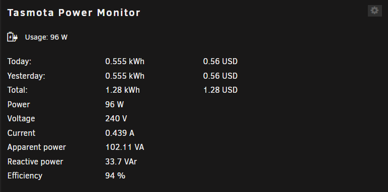

Just updated to 6.12, relitively smooth but had a panic with "Unmountable: Unsupported or no file system" after enabling the "Permit exclusive shares:" option. Luckily a reboot fixed it, panic over for now.
Now to take a look at this!
349496925_Screenshot2023-06-16at22_35_26.thumb.png.5eda8d327aefd30ba6c4dd9f6a0432be.png
Appears to be working - however, there appears to be a pretty nasty bug.
After a few seconds (iterations), the values stop updating at the set interval (tried at the default 1000ms, 2000ms, etc) and instead start racing along faster and faster until either the tab or browser crashes.
It also caused the plug to overload and reset as well, presumably due to the amount of requests being performed overloading its little webserver.
There is a video of it malfunctioning attached.
This is with the default polling rate of 1000ms, in FireFox 114.0.1.

Nice little plugin, I just found it!
But as a side note, the "Efficiency" at the bottom is in reality the power factor. Something completely different.
