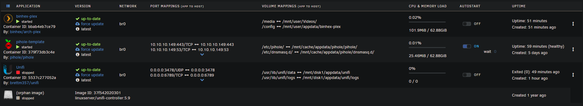

so for the past few days i've been dealing with an issue with docker containers resetting after server reboot.  i updated unraid after the reboot. i noticed that my unifi controller (docker container) had been reset. didn't think much of it and i always keep a backup of the config and fed it the backup file and was on my way. Just yesterday i went out and was trying to watch a movie on my plex also in a container and noticed it was offline. when i got home and logged into my plex i noticed it was reset as if i were setting it up for the first time.
So i spent the hour or so getting it all set back up and then reboot the server logged back in and the docker containers were reset again.
unifi controller, plex, and pihole main containers i run and all get reset.
things i've tried are deleting the docker image file, deleting appdata, and deleting the docker templates. after all that docker still seems to reset the container after server reboot.

fix common problems is telling me "Invalid folder cache contained within /mnt    Generally speaking, most times when other folders get created within /mnt it is a result of an improperly configured application. This error may or may not cause issues for you"
could this be the problem?
this is what's inside it.
/mnt/cache/appdata# ls
binhex-plex/  pihole/

Then you need to change all references to /mnt/cache in your container definitions to /mnt/user instead of /mnt/cache.
Since you don't have a cache drive, anything written to that path only exists in RAM and will be gone after a reboot.
Once you have removed all references to /mnt/cache, then reboot, you should be able to set things up permanently.

That would make sense but from what I can tell none of my containers have mappings to that directory.
Oh yeah I see that now. OMG I must need sleep or something.
So I fixed that, deleted the cache directory and rebooted the server. So far everything seems to be working.
My guess is that one of the docker containers created that directory and a few started using that causing the configs to be wiped on reboot.
