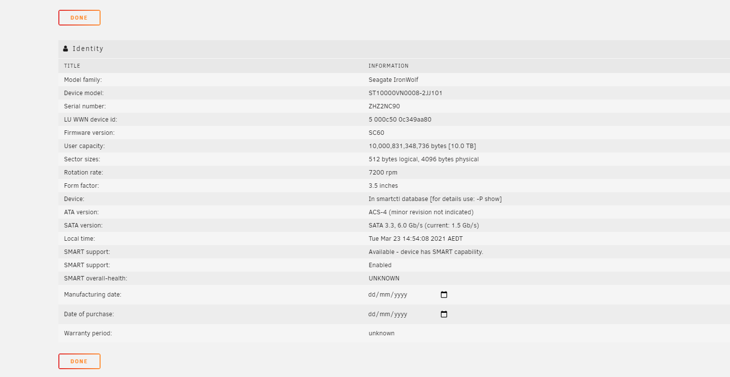

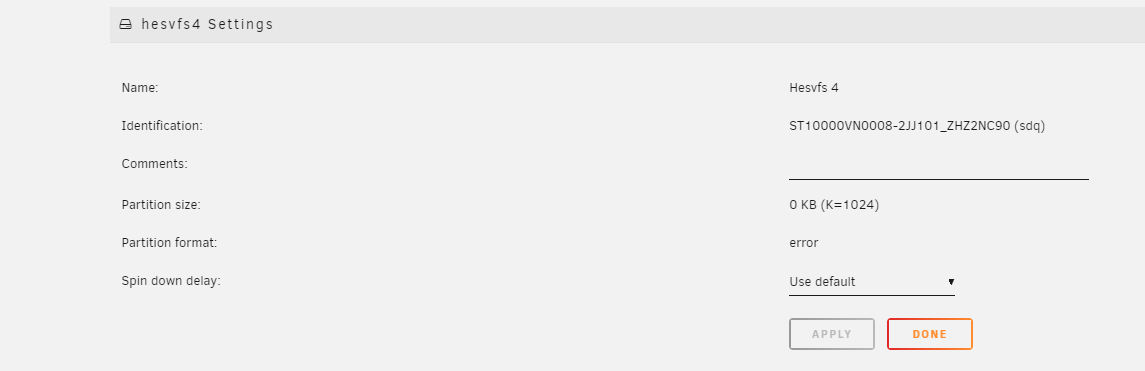

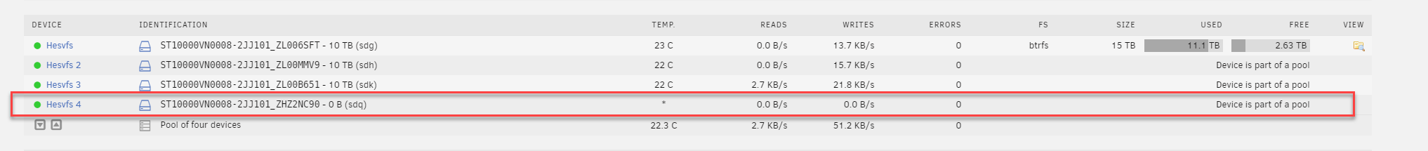

I have several Pools setup under the latest release of unraid, one of the drives in a set of 4 has a bad partition and i would like to just format that drive. Is this possible and please how would i go about doing this?
i believe the pool is Raid 1 but the drive has not been connected properly since i added it to the pool which was after i had been using it for a while, origionally it had 3 drives.
image.thumb.png.36fb79c4a1d0b211a3b85bbf225e6814.pngimage.thumb.png.ebd846a1d7adf637db96d37be6d11e7e.pngimage.thumb.png.4f1c20f79ff9bdfcb5820a7bc97929cb.png

This seems odd indeed to have the disk detected as 0TB.
Your diagnostics might give some additional information. Please add the zip in your next post. (Tools / Diagnostics)
backupserver-diagnostics-20210324-1225.zip yeah i though that was strange too and as well no temp on the drive
but when i saw that the partition error i just put it down to not being able to join the pool raid1 because of this.
thought formating it would give it a kick start
Disk sdq has dropped off-line. It looks like you have cable/controller problems but it's difficult to read your syslog because it's extremely cluttered with this, repeated every few seconds:
Mar 22 21:09:33 BackupServer kernel: iSCSI Login negotiation failed.
Mar 22 21:09:38 BackupServer kernel: Unable to locate Target IQN: iqn.2003-01.org.linux-iscsi.backupserver.x8664:sn.bcd8fdb5bf9c in Storage Node
According to your diagnostics, btrfs pool Hesvfs has only three members, sdg, sdh and sdk, though the GUI thinks there are four. So it looks as though sdq dropped off-line before it could be added to the pool. I'd start by stopping the iSCSI stuff, shutting down, checking the cables, especially to sdq (you've got the serial number in your OP), and also sdn, sdo and sdp, then booting up, starting the array and grabbing new diagnostics. I see you have a Marvell SATA controller, which may be causing problems.
