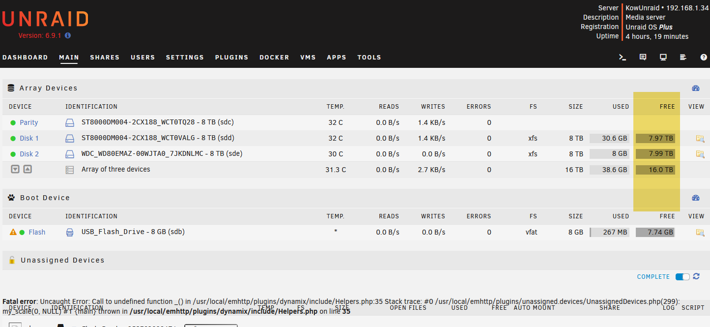

So - yesterday I found myself unable to access my unraid server.  Hooked up monitor to machine and booted up and saw a message about it being unable to find some .sys or .dll file (can't recall the exact error message).  Searched for the error and saw suggestion 'plug into a windows PC and look at the USB drive to see if the file is there).  USB drive plugged into computer was empty.  I assume bad USB drive.  Download some data recovery software -- it finds all (most?) of the files.  I recover the config folder -- though it has a couple filenames with a _ in place of the original start letter for some reason . Fix file names, run the 'create USB' tool from the Unraid website -- then copy config files back over to drive.    Try booting up server.. everything seems to be going ok.. hurray.  Try to connect to the share i created.. can't connect.  Load up the web interface and to my horror it shows both my drives (3 total - 2 8TB data drives and 1 8TB parity drive) as having darned near 100% free space.  I had nearly 13 TB of data on them. Immediately shut down server.
Was thinking maybe USB was still corrupt and that impacted something.. so created a new USB drive, replaced key, etc -- but I'm still seeing the same thing.
Am I completely hosed here? I don't understand how/why the data would be gone ... do I have any hope that it's still there and I can get to it somehow?  I have no idea what step to take next year...

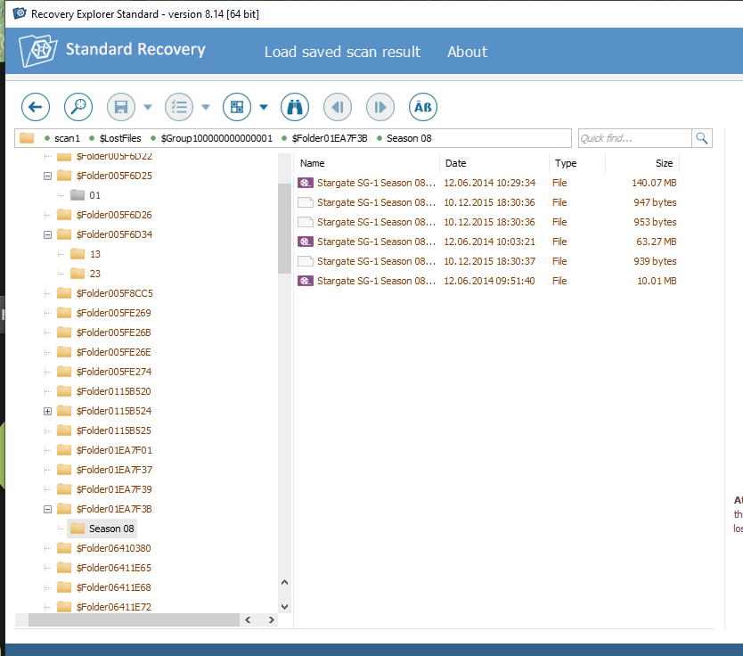

_early_ results using USF Explorer trial (well, actually the cheaper 'Recovery Explorer Standard') shows I may be able to recover some data.. scanning is taking a _lot_ time ... I canceled after it was like .1% done just to see if it had found anything - and it appeared to indicate it had.
Now the problem I have is that I don't have any storage available to recover the data on to .. may be time to buy some additional hard drives I suppose...
Question - what do the files look like on the drive normally?  I'm trying the USF Explorer and it's finding files - but I'm unclear if the folder structure is just lost/hosed, or if it is how the files were actually stored by the filesystem ...

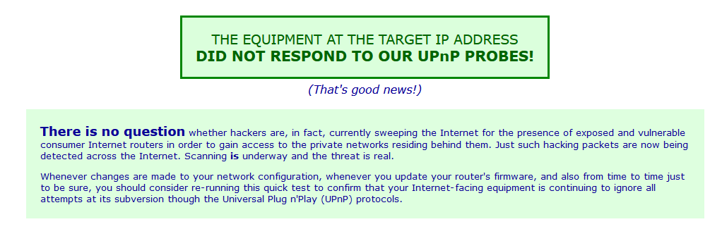

I also prefer to disable Universal Plug n Play (UPnP) on my router.  It was designed for local networking discovery only but has been exposed and exploited over the WAN by past problems.

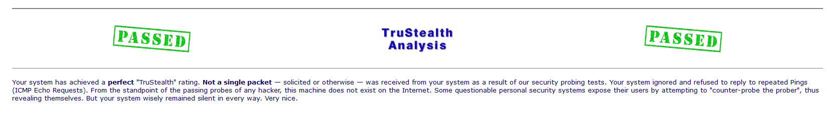

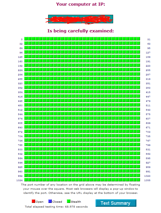

Although some question the methodology and conclusions of the author, I use the tools at Gibson Research to get an idea how secure my server is from access from the outside world.  Specifically, I run the Shields Up! UPnP Exposure, Common Ports and All Service Ports tests.  You can also test specific ports like those commonly used for external access by trusted applications such as those mentioned above.
Results like this indicate your server is not responding to random connection requests from the Internet:

Anyone catch my question about the file system and layout of the files?
Would I expect to see a folder structure on the drive that exactly mimics what I see when browsing my file share.. (like.. a \media\, \media\tv shows\show name', etc etc ) -- or are things like the $Folder06411E68 that this recovery utility finding the actual folders that would have existed on the drive?
What you are seeing is normal for most recovery tools.  When a drive is "wiped" the filesystem which tracks the folder structure is overwritten and no longer exists and the pointers to files in that structure are also gone.  However, most of the data is still on the drive (unless it was overwritten) and the recovery tools just do a sector by sector scan to see which contain data.  The recovery software can no longer tell you how/where it was stored in a folder structure.
Thanks, I largely figured as much, but I am not familiar with the XSF file system and never looked at how it was actually storing the files on the actual drives - so wasn't sure if there was something goofy going under the hood that somehow got translated to the folder structure I was seeing somewhere.
Better than nothing I suppose ... for media shouldn't be horrible, everything named pretty consistently so should b eable to manually sort it if I put some time into it.... for random backups of hard drives i think I'm just going to have to chuck it up as lost...
