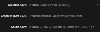

I need help getting GPU passthrough on my newly created ubuntu server 20.04.2. The GPU I try to passthrough is a NVIDIA P400.
I have added the edited rom file and selected both the GPU and "audio" from nvidia in unraid.
Every time I boot it with the GPU it will not start. I can't connect with PuTTy. If I change it to VNC I can connect with PuTTY after a minute.

IOMMU group 63:[10de:1cb3] 82:00.0 VGA compatible controller: NVIDIA Corporation GP107GL [Quadro P400] (rev a1)
[10de:0fb9] 82:00.1 Audio device: NVIDIA Corporation GP107GL High Definition Audio Controller (rev a1)

Okay, so I finally figured it out. It was the network adapter in ubuntu that caused all the issues. After resolving it, everything turned out fine!
Anyway, I also found out that dumping the vbios myself is a much better approach then using one from tpu and edit it. I had to use the "put to sleep" mode even when the card was not being used in the dump vbios script.

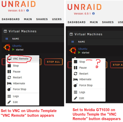

To answer your question, YES, when I have it set to VNC I am allowed to make a "VNC Remote" menu selection which envokes my Ubuntu VM inside a VNC window on my Windows10 client. However, if I change VNC to Nvidia GT1030 on my Ubuntu template the "VNC Remote" menu selection button disappears and I do not see my Ubuntu VM on either my Windows10 Client monitor or my UnRaid Server Monitor which is connected to my Nvidia GT1030.

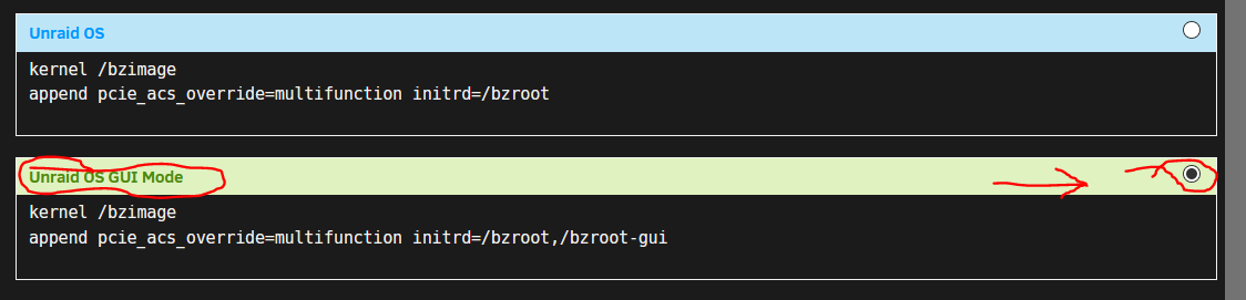

I think my problem is I am thinking about all of the this in the wrong way. I am expecting my Nvidia GT 1030 card to support both my Ubuntu VM video output and also my UnRaid GUI video output. When I plug my monitor to the VGA port on my SuperMicro Motherboard I see the hundreds of lines of code the Unraid OS shows in the very beginning of the boot process. But then my VGA turns black and does not show my Unraid GUI. So I can't use my UnRaid server as a stand alone PC. I have to get on my Windows 10 client PC and connect to my UnRaid Server using my FireFox browser.  If I want to start my Ubuntu VM I can start it from my UnRaid OS GUI inside my FIreFox browser and then eventually I see my Ubuntu VM on my monitor that is connected to my Nvidia GT1030 card. But I see the VM within a noVNC. In short, right now I have two monitors connected to my UnRaid Server. One monitor is connected to my Supermicro VGA port and then  I have a second monitor that is connected to the HDMI port on my GT1030 card. My GT1030 monitor only supports my Ubuntu VM launched from my Windows 10 client PC.  My VGA monitor does not get me to the UnRaid OS GUI. It turns black after all of the text code comes to a stop.
In a perfect world I would like to have a single monitor connected to my GT1030 card that supports both my UnRaid OS in GUI mode and also my Ubuntu VM.  Is this thinking right or wrong?  And is it necessary for me two have two separate monitors connected to my UnRaid server?
I will try disabling my "PCIe ACS override" parameter because right now I have it set to "Multifunction".  I hope this will fix my VGA monitor problem going black and showing me my UnRaid OS in GUI mode.
Are you loading the ast video driver?
Also if you boot in non gui mode do you get login prompt on vga monitor.
You cant use the 1030 for both outputs.
