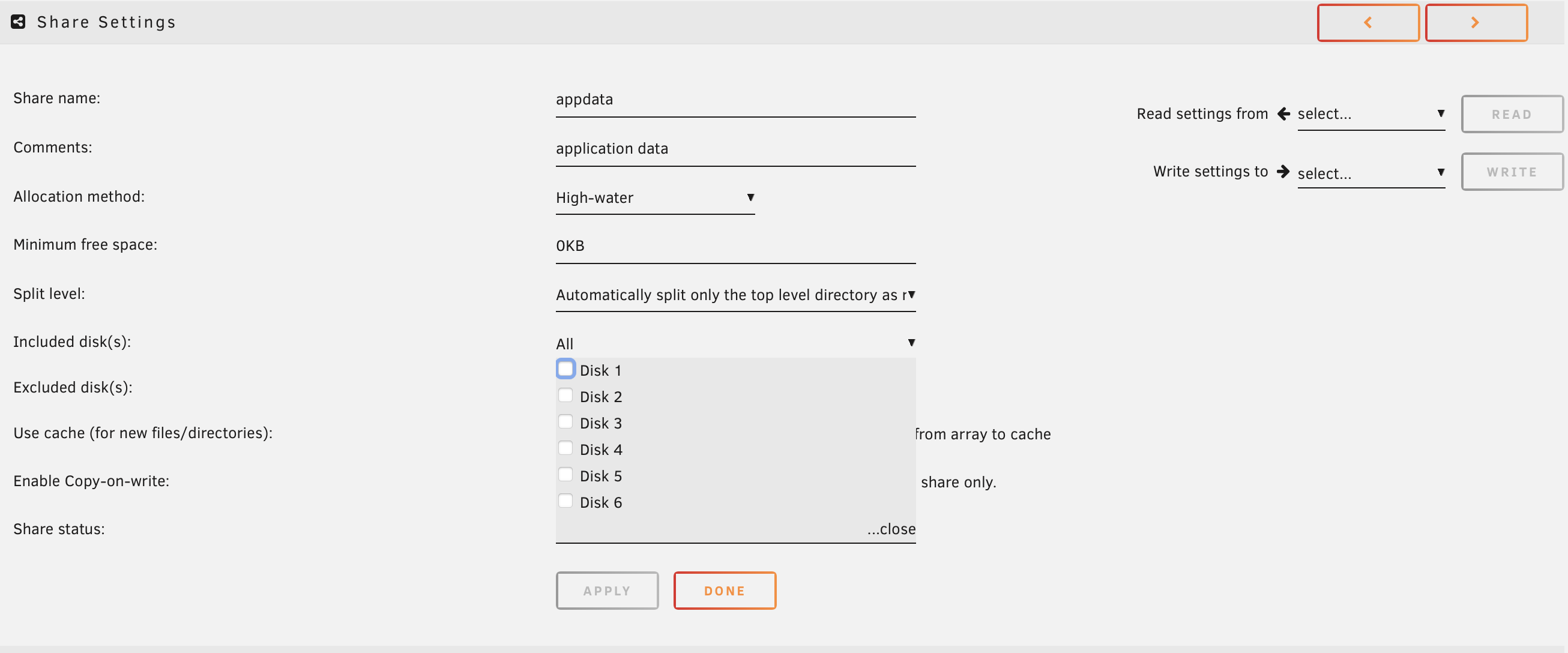

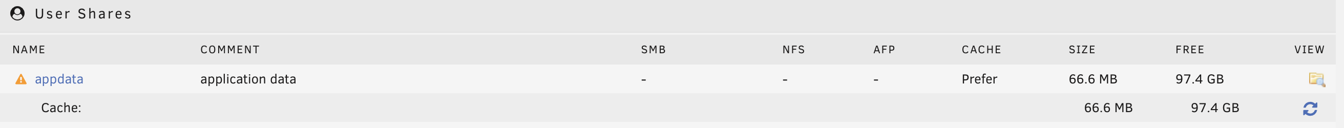

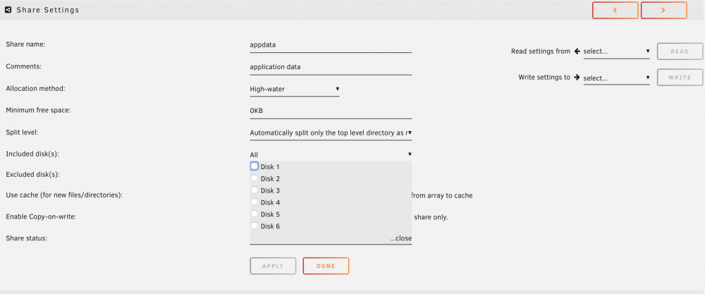

sorry for my beginner question.. it's a new "word" for me... how can take and put my appdata (with Plex too) on my cache drive (yes is a SSD)??  My appdata is on my third and 5th HDD.. Have I to share my ssd and change in the Share Setting the "Included disks" into SSD or... is there an another method, like Drag and drop??
I assume you have the docker for plex set up and running?  If so go to your shares tab.  On appdata set cache to “prefer”. Stop all your dockers and go to settings and disable docker. Hit the “move now” button on the main page and allow it to finish. It could take a long time as plex appdata has a lot of small files. When done enable docker and start your dockers up.  I assume your plex appdata is already in the appdata share.

If it’s a set up as a share it will move the appdata from all drives
sorry.. I've not understood... is it important the directory location of appdata? Is better on SSD or not?
Yes put it on SSD cache drive

... this is the problem.. how can do it?? For now appdata is in my Array (on 3th an 5th HDD)  and the SSD works only for Cache. To change the Appdata directory is enough to set SSD instead of the previous HDD?? OR... put in share the SSD (cache) also and will I use the browser as the others folders?
Edited by Alcarimon
Post your diagnostics from the tools tab.
According to your diagnostics appdata and domains are now completely on cache, but system has files on the array.

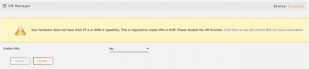

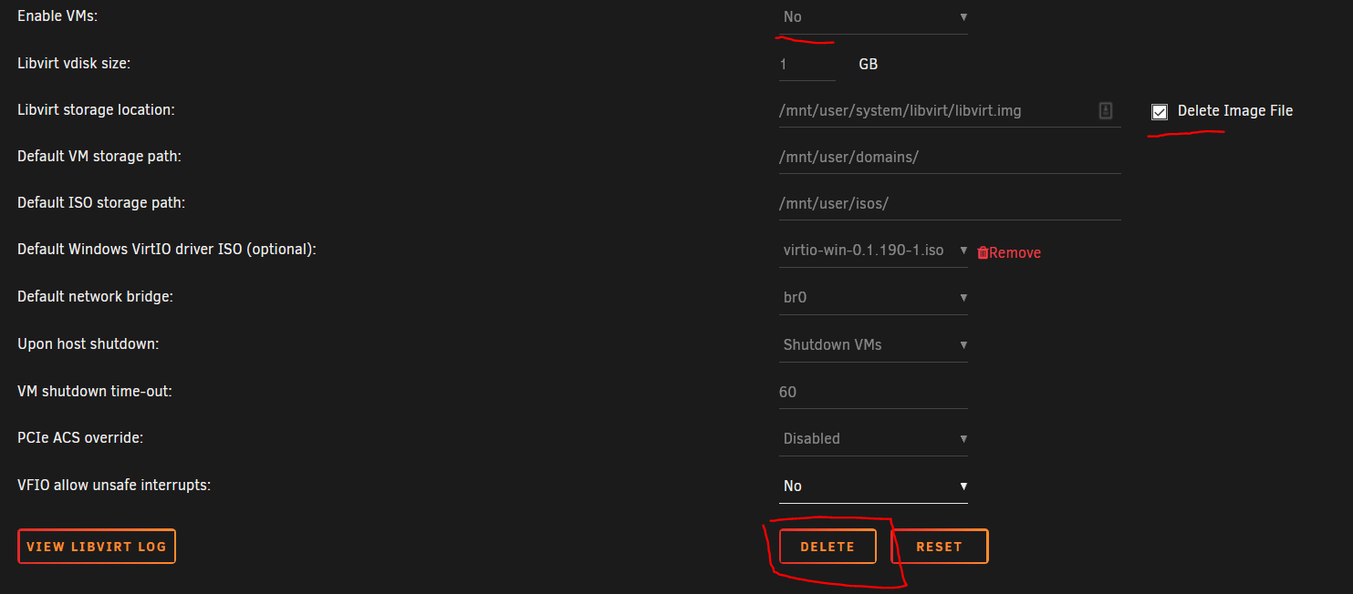

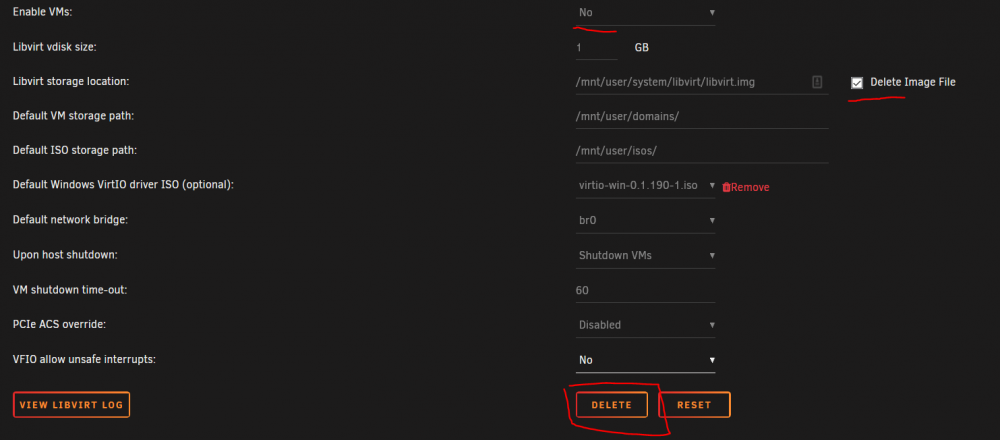

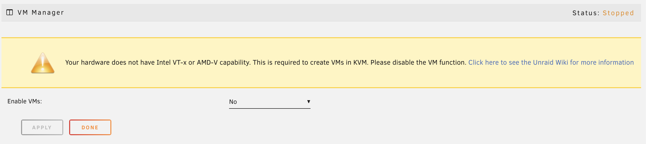

59 minutes ago, Alcarimon said:
I setted in "NO" VMs but  How or where can delete libvirt.im?
Once the VMs service is set to No, Apply.
Then check the box that says Delete Image File and hit Delete at the bottom.
mmmm
1306318454_Schermata2021-03-25alle22_25_56.thumb.png.b0631353e1eaa3b88603f263714938b7.png
