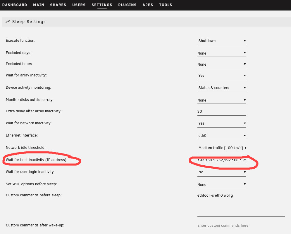

Before upgrade, my server was able to follow the configuration settings in Sleep
and went to shutdown mode when it sensed my PC's IP = 192.168.1.247 has shutdown.
That is under,  "Wait for user login inactivity (IP address)"  see the picture below.
However after the upgrade, server seems to ignore this setting.
Can someone able to help me out?
I have attached my diagnostic file below.
Thank you.
Edit: There is another problem I am facing with my Unraid Server, after the upgrade,
I could not get server turn on using Wake ON Lan method.
In order to turn it on, I need to run upstairs and manually press the ON/OFF
button.

After unraid updated to the latest version of Dynamix S3 sleep that is
s3_sleep version: 3.0.8 which created on the 13-03-2021, still does not work at all. 😔
Due to Covid lockdown, I took some time to troubleshoot my problem.
I migrated my unraid to another motherboard, then I reinstalled Dynamix S3 sleep after I removed it first.
After that, include the command: "ethtool -s eth0 wol g" - into Custom commands before sleep.
Applied the settings.
Next thing I know was, all my samba share was lost - which is expected to happen (because my Dynamix S3 sleep)
but it was a surprise to me, I didn't know by reinstalling the plugin would solve my problem.
Hooray!!!!.......S3 sleep is now working. I can now send WOL packets to the network card's MAC address to wake up unraid. 😀
