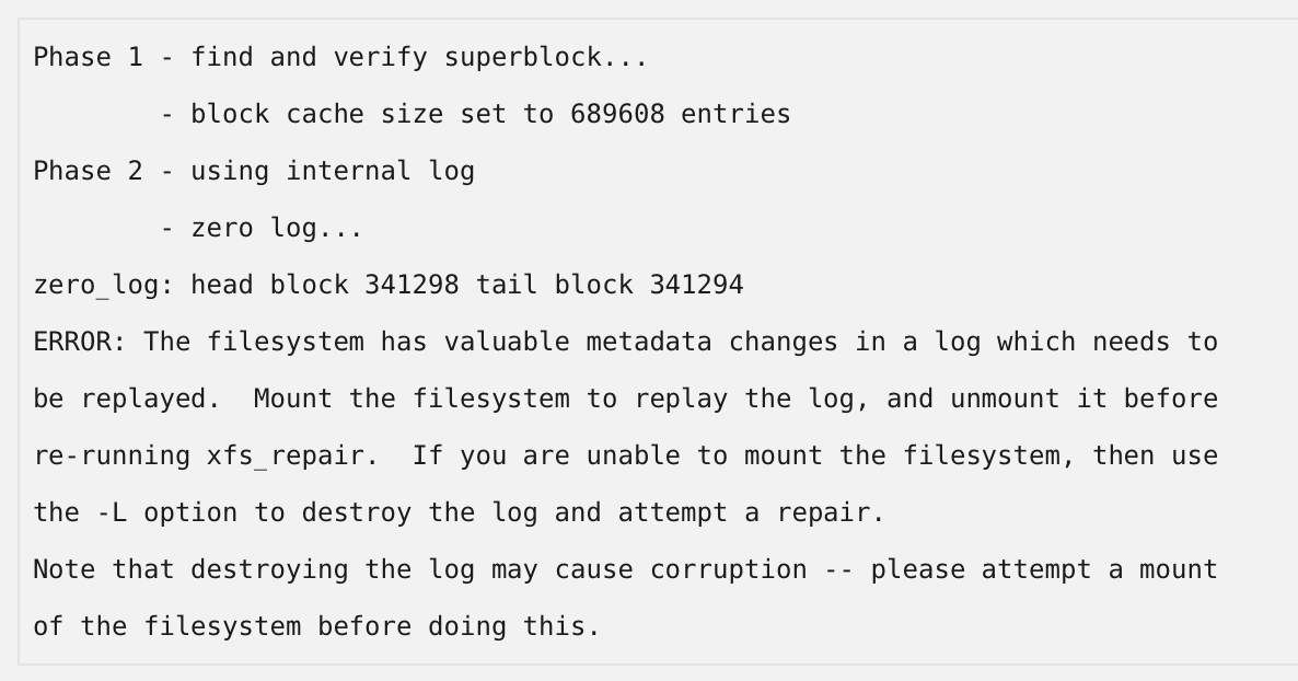

It was Disk 3. Since it's no longer present in your server its contents are being emulated. But there's also file system corruption so the emulated disk won't mount. First thing is to try to repair the emulated disk by running a file system check on it. So stop the array and re-start it in Maintenance mode, then click on the text "Disk 3" (on the Main page). Scroll down to Check File System Status and run the check. If you leave the "-n" in the box it will only read from the emulated disk and won't actually make any changes, so delete the "-n". You can replace it with "-v" to make the output more verbose. Wait for it to complete and post a screenshot of the result.
Run it again, with the "-L" option. It won't cause any more corruption. It just deletes the journal.

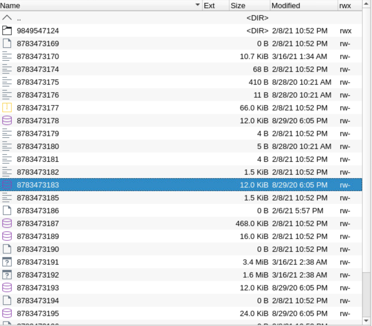

9 minutes ago, riZnich said:
moving to lost+found
You have a new User Share named lost+found. Take a look there to see how messy the repair was.
Looks like I lost a folder from a docker resilio sync - but it didn't have any active content and then I have a handful of files that are super small
It is often the case that repair can't figure out what folders a file belongs in, or indeed, what the names of folders and files are.
