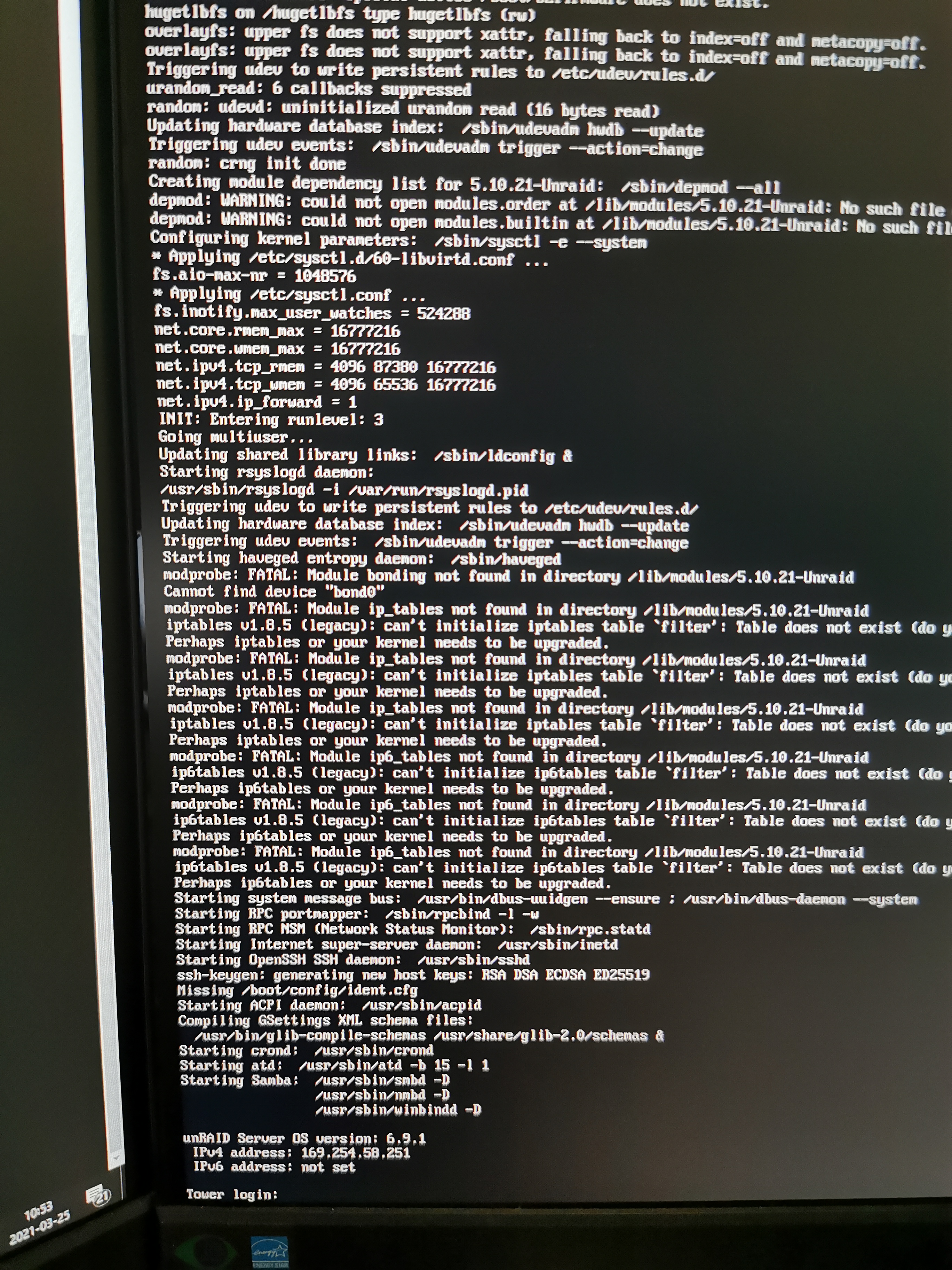

I don't know if I messed something up with my manual powering downs. Now I am not able to log in using the webui. I get a strange ip that is not in my network, how can I fix this ?
That means the server is not getting an IP address from your router.
I googled my problem and found a post where the creator had a similar problem and it was the usb that was broken/corrupt. I have now replaced the usb with a backup and unraid boots again and I have access to the webui. But how do I solve my problem ? I can start the array again if I disable VM in the setting. But how do I alter the Windows10 vm that is causing all the problems when VM is disabled ?
