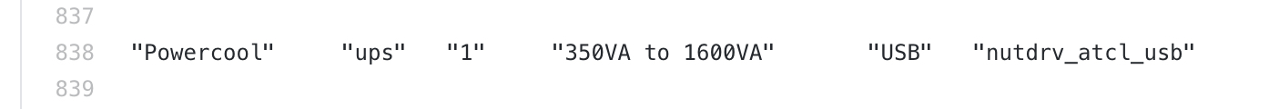

but it kept setting the driver to blazer [which reading in the NUT manual - LINK is what is it], but then further reading and googling found this:
Discussion on the Powercool and the nutdrv-qx driver
GitHub

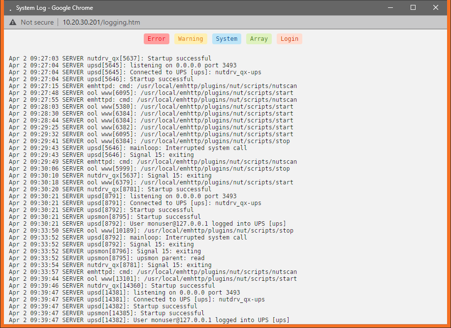

so put this [without quotes] into the ups.conf in the editor at the bottom of NUT settings and set USB driver to custom nutdrv_qx
and that is the limit of capabilities.

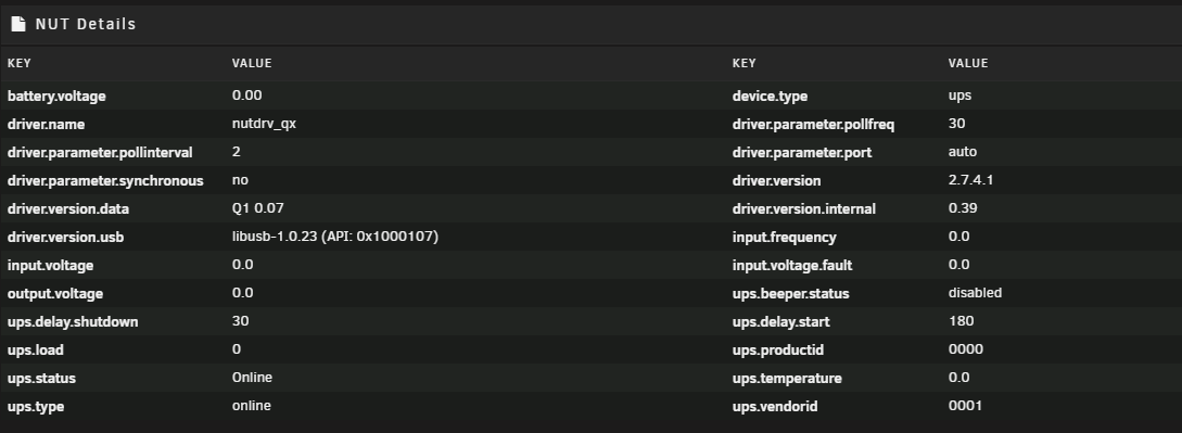

The screenshot shows status online. Does it change when you turn off the outlet that supplies power to the UPS? Obviously all such testing needs to be done with the server powered on a separate circuit.
no, it stays ONLINE the whole time.

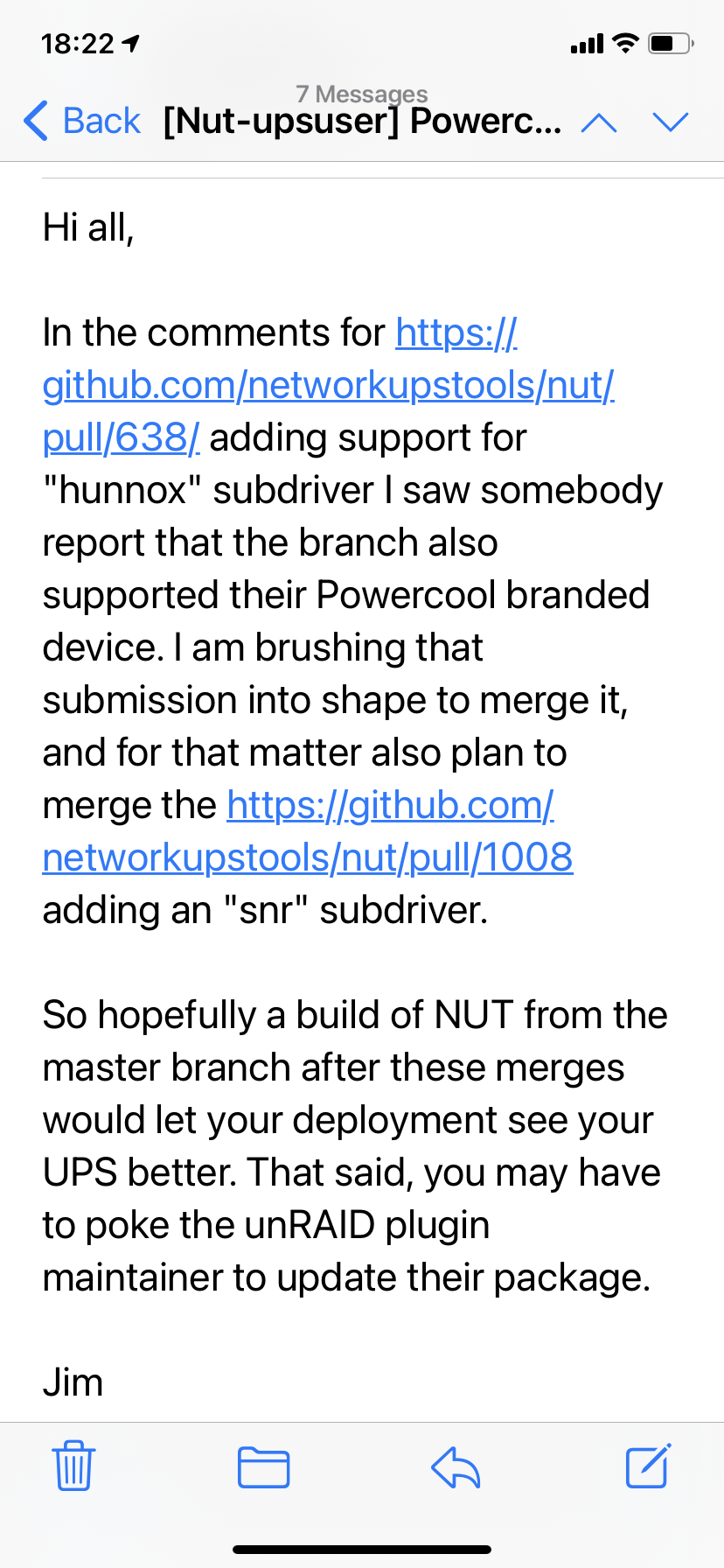

No news yet I’m afraid. I’ve reached out to NUT to see what they say.
