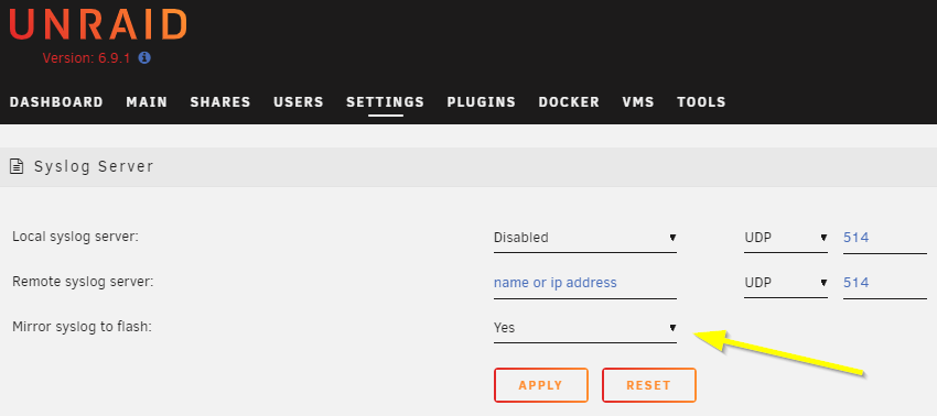

Ja, du kannst die Logs dauerhaft auf den Stick schreiben lassen:
Vielen Dank. Hab es aktiviert, mal schauen was ich da finde.

Jun 7 10:51:15 BlackCastleServ root: mcelog not installed
Jun 7 10:51:16 BlackCastleServ root: Fix Common Problems: Other Warning: Mover logging is enabled
Jun 7 10:51:18 BlackCastleServ root: Fix Common Problems: Warning: Syslog mirrored to flash
Jun 7 10:51:18 BlackCastleServ root: Fix Common Problems: Warning: The plugin usb_manager_usbip_addon.plg is not known to Community Applications and is possibly incompatible with your server
