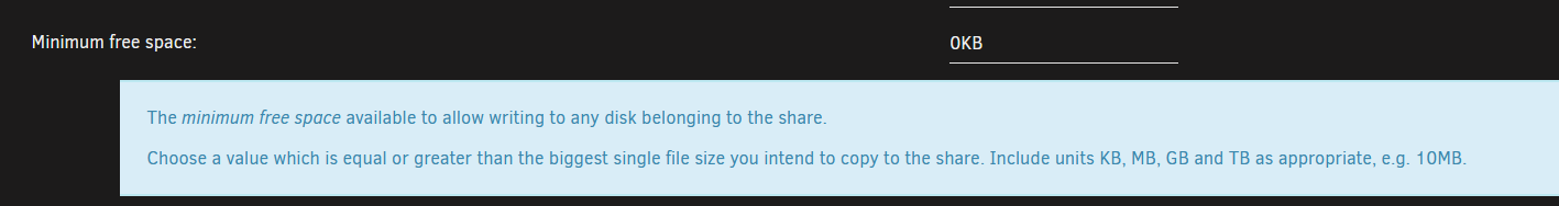

5 hours ago, CaptainTivo said:
how it got down to 48M when the minimum free space was set to 48GB is a mystery
Minimum free doesn't mean don't allow the disk to get less free space than that. It means IF the disk has less space than that, choose another disk.
Unraid has no way to know how large a file will become when it chooses a disk for it.
For example, if Minimum is 20G and the disk has 25G free, it can be chosen, whether the file you are writing is 15G (succeeds) or 30G (fails).
This makes sense. BUT, what happens when it is writing a file and it runs out of space on that disk (in your words, Fails)?  I assume it simply chooses another disk and then tries again?  Otherwise, how is the user informed that the write failed?
No, it just fails. Up to the application writing the file to inform you of that.
That's is why it is generally suggested to set Minimum free space over the expected maximum file size for this share. As stated in the tooltip.
