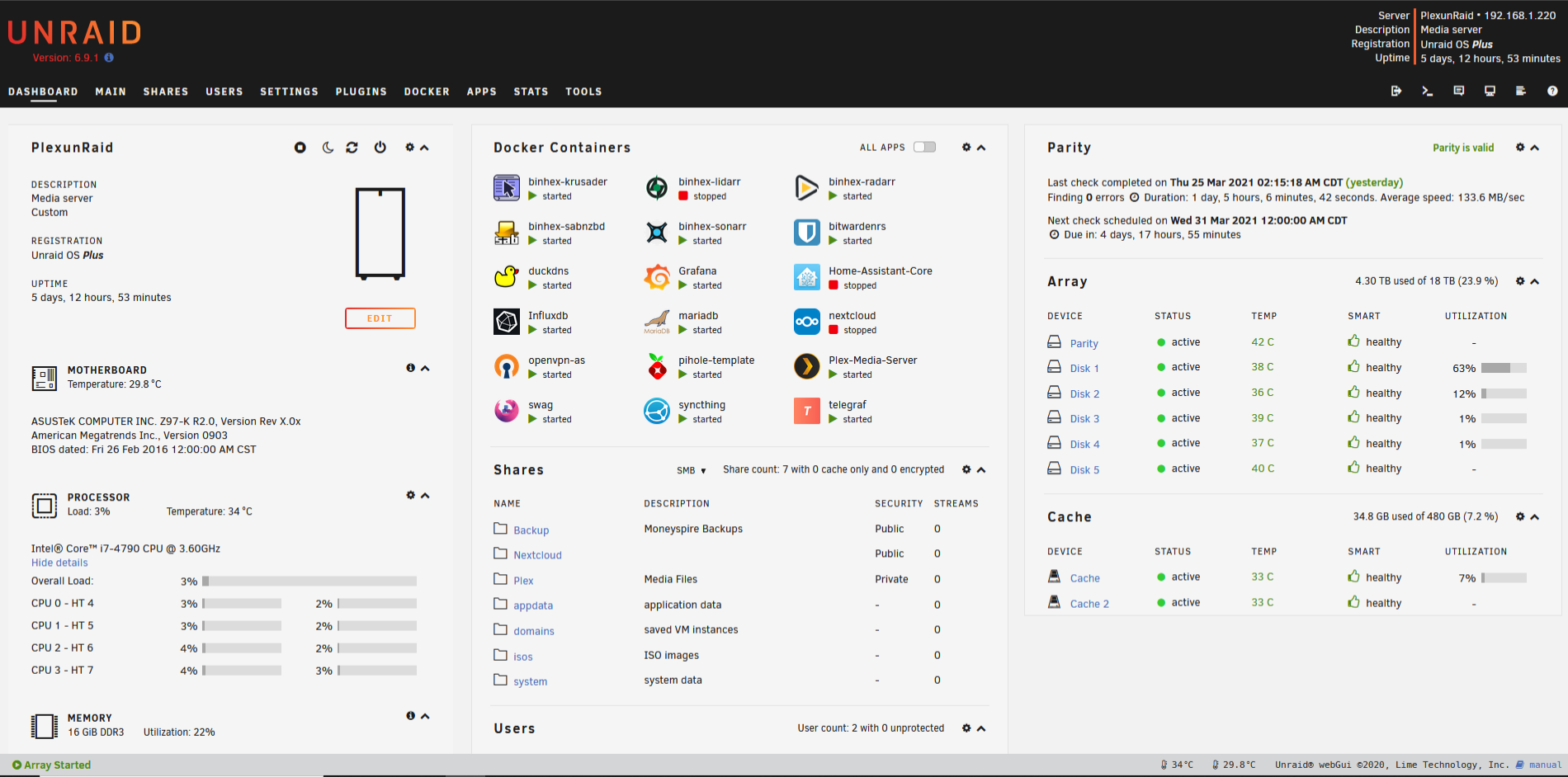

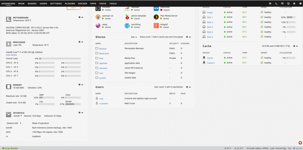

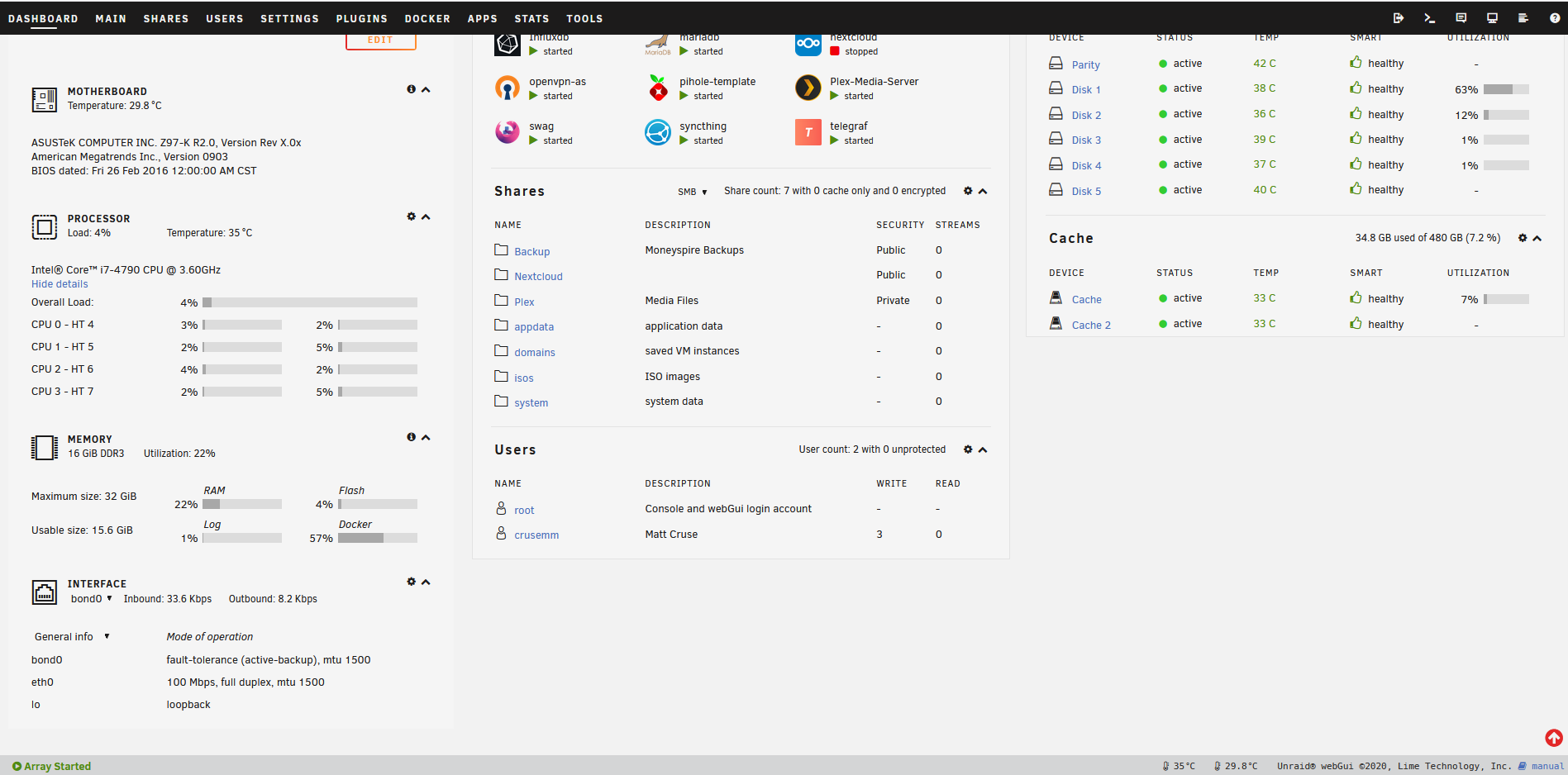

You should have a format option on the bottom of the main page next to start/stop buttons, if you don't please post a GUI screenshot.
I do not
I am so dumb, I looked and looked for it and couldn't find it. And 5 seconds after posting those screen shots, there it is, under the main tab.  Thank you
