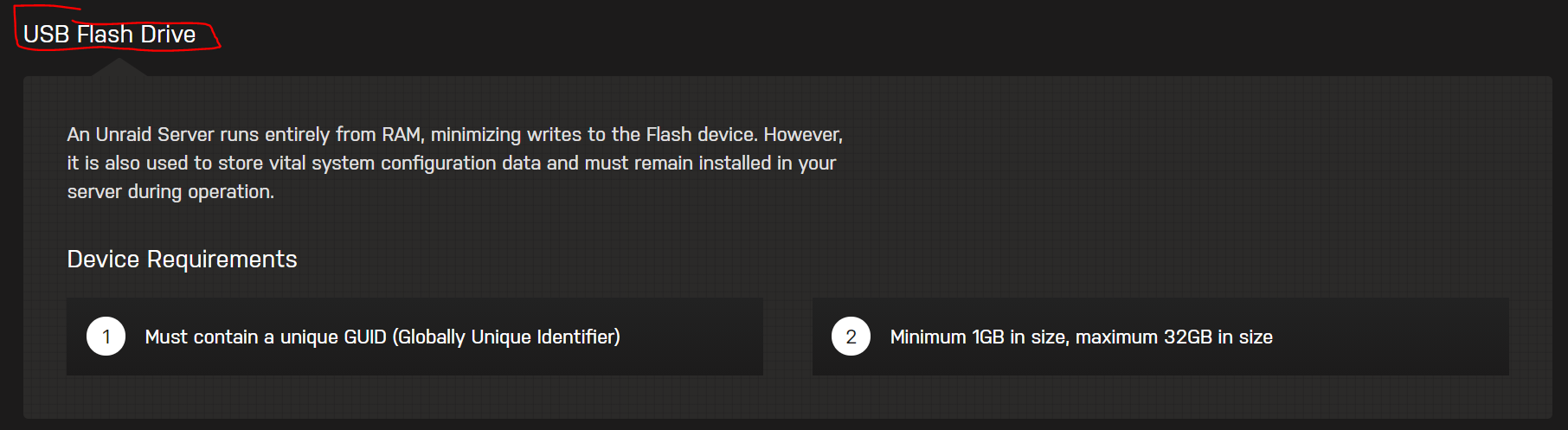

Wording might be improved ?
Could be.
In these days when you can run a full fledged distribution with persistence/portability from an SD card, the difference may not be immediately obvious or slip by, like with me.
If I may suggest:
Prerequisites
--- snip ---
You will also need a quality USB flash device that is 1GB or larger.
Note that SD cards are not supported. For full hardware requirements, visit our product page.
